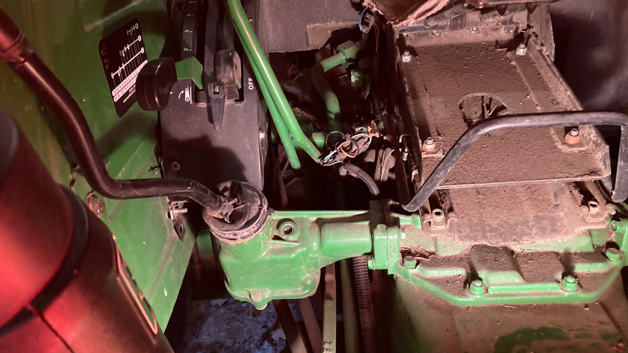

Eureka!
Update: It was even colder today (teens), so I went and checked it out again. Without starting tractor, same thing happens. It won’t go into the gears (reverse and 1st) that are “below” the neutral positions on the shifter. Goes into 2nd and 3rd “above” the neutral passage just fine. Hmmm...why would that be, if I’m getting ice at the bottom of hydraulic oil in trans?
Yesterday I thought it was an external linkage problem given that 2 “up” gears worked, and 2 “down” gears on shifter didn’t.
Today, I thought I could hear or feel “crunchiness” at shifter, or at top of trans.
I don’t know much about transmissions, but started wondering what actually defines the positions/ slots where a shifting lever moves (or in my case doesn’t move)
I suspect whatever is inside this green enclosure at the bottom of the shifting lever where linkage is redirected horizontal into transmission is the problem and has water in it. I heated it with a blow dryer for two minutes and then could easily shift into all gears.
I’ll take the cover off the bottom of it when I change the filter and see what leaks out.
The boot is good, but I did have to replace it maybe 6 years ago. Weird that this was never a problem any of the winters since then.

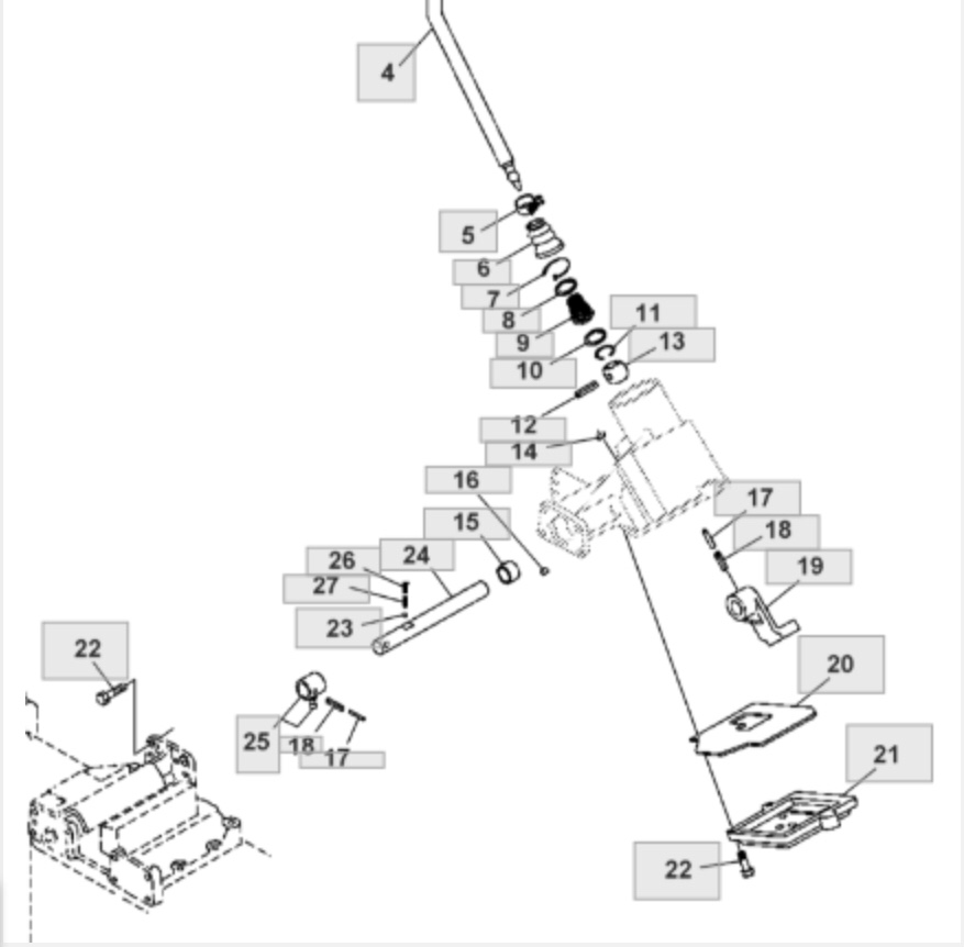

   / 5075E Hydraulic / transmission freeze and thaw. -linkage #13
Well that sounds a whole lot better then getting ice inside the transmission.
Have you had that bottom cover off before?
If it's just a cover or a support for and shift rails could make a difference.
Have you seen an exploded picture of that housing?
Good luck with her it's starting to sound like you may be needing her tomorrow.

Guess we were both looking at same time. Looks similar.

Follow up:
I loosened the bolts on the bottom cover plate and let oil (and water?) drain out. Not wanting anything to fall out, I didn’t take cover off, so I hope that when oil ran out it flushed the “cup” of the bottom cover.
There might of been some water. Maybe a little milky, but I couldn’t really tell. I should of collected it in a pan instead of letting it disappear into the oil container.
Hopefully that did the trick, It got cold that night, and no problems since.
