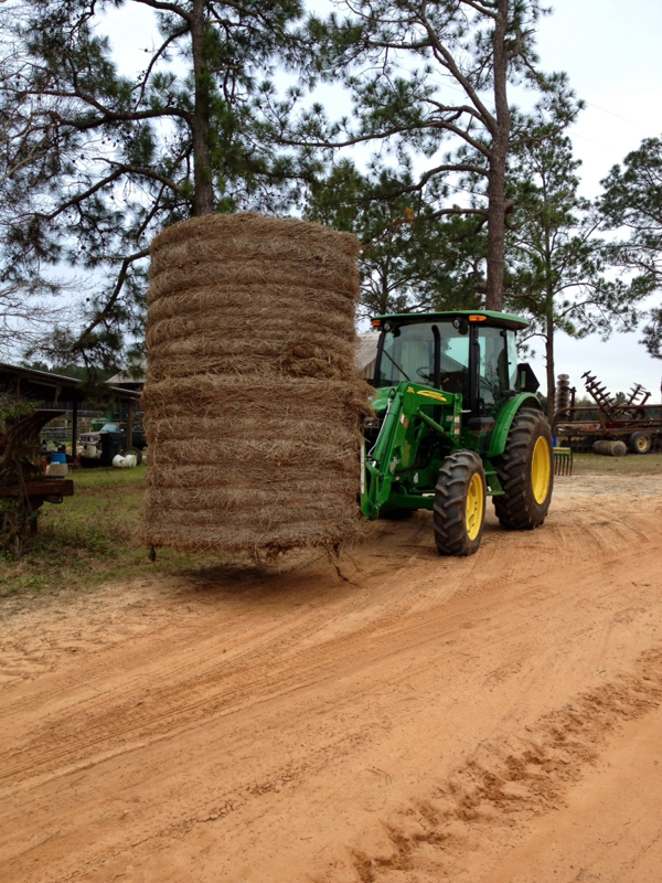

I can't believe you guys are operating loaders without ballasts. The Manual for the H310 specifically states minimum ballast is just over 4000 lbs with more than half on the 3 point and the rest on the rear axle (tire fill and or wheel weights). OMW55317. I have a 5075M with H260 and carry 2200 lbs on the 3 point and according to the manual, I should have additional 900 on the axle and 700 lbs more without the cab. As for the LSS, I don't have one, but it is used for transport only over rough terrain. It is to be turned of for digging and back dragging. You be the judge on how you will use your loader.
http://www.tractorbynet.com/forums/attachments/attachments/364575d1394392334-ballast-photos-ballast-010.jpg

Some people just aren't that bright. The two 6r tractors I ran were someone else's. I said he should ballast it but he didn't care. That person swaps out tractors every year so he doesn't care about that stuff, he doesn't even know what he's got. I've got the 553 loader on my 5083. Since it's got a cab it's rare I need any ballast.
My rear wasn't even a little bouncy and all I had on the rear was a little landscape rake.

As far as ballast I use all I can get, the 6430 with cab, winch, tire chains, and full length skid plates and limb risers weighed in at 18,500lbs. I regularly lifted carried and loaded logs that weighed over 4000lbs onto trucks and trailers. I only ever felt light when i lifted a pallet with 64 80 lb bags of concrete. My main concern then was the front radials.
