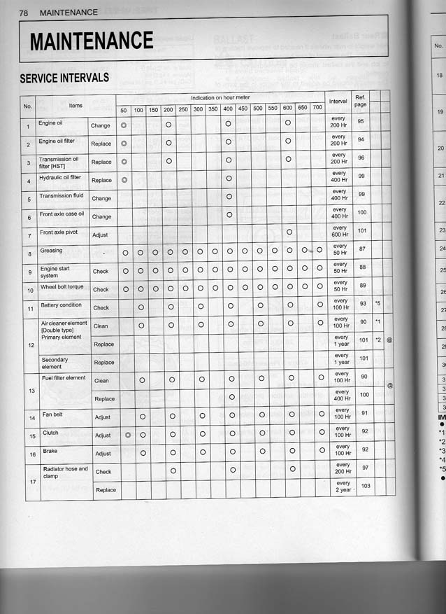

The attached scans are from the same Kubota manual that covers all the Grand L 40 models from the L3240 - L5740. As I have posted previously, I find this Kubota manual "confusing" on the subject of when to change the transmission fluid...
The Maintenance Service Intervals table (GL40 Maint Table.jpg) indicates to "Change Transmission fluid" every 400 hours. And the detailed service instructions referenced on page 99 (GL40 Hydraulic Filter.jpg) describes that procedure in conjunction with replacing the hydraulic oil filter. BUT....

FWIW I have a nasty habit of thinking for myself. So, I can't remember ever following ANY instructions/manuals literally. I changed all 11 gals of UDT at 50 hours and will just replace the filters -- and the lost UDT with new UDT -- at 200 hrs (probably at the end of this week). Then I'll change out the full 11 gals of UDT again at 400 hrs.
