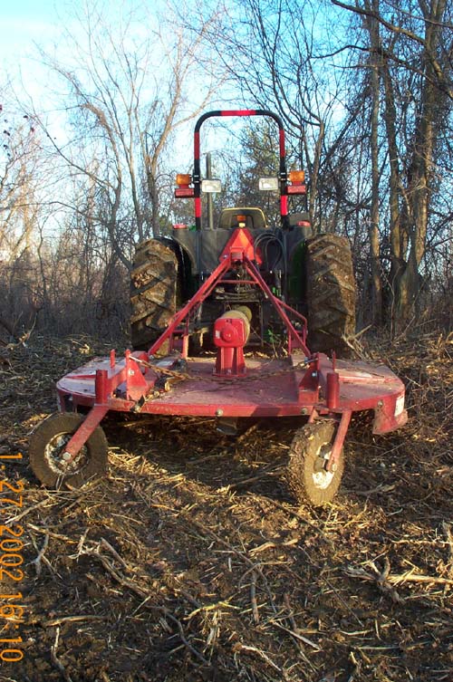

Brush hogging in NE USA January 2002 like Spring/Summer Day...!
Placing a picture/attachment in-line...
1. Upload "attachment file"
2. Go back in "Edit Mode" and Edit your post...
3. Grab "url" of your attachment, insert/edit your post
4. Hit "Change this post" button
   / 50W Headlights #52
Let me see now, hog does this work?
