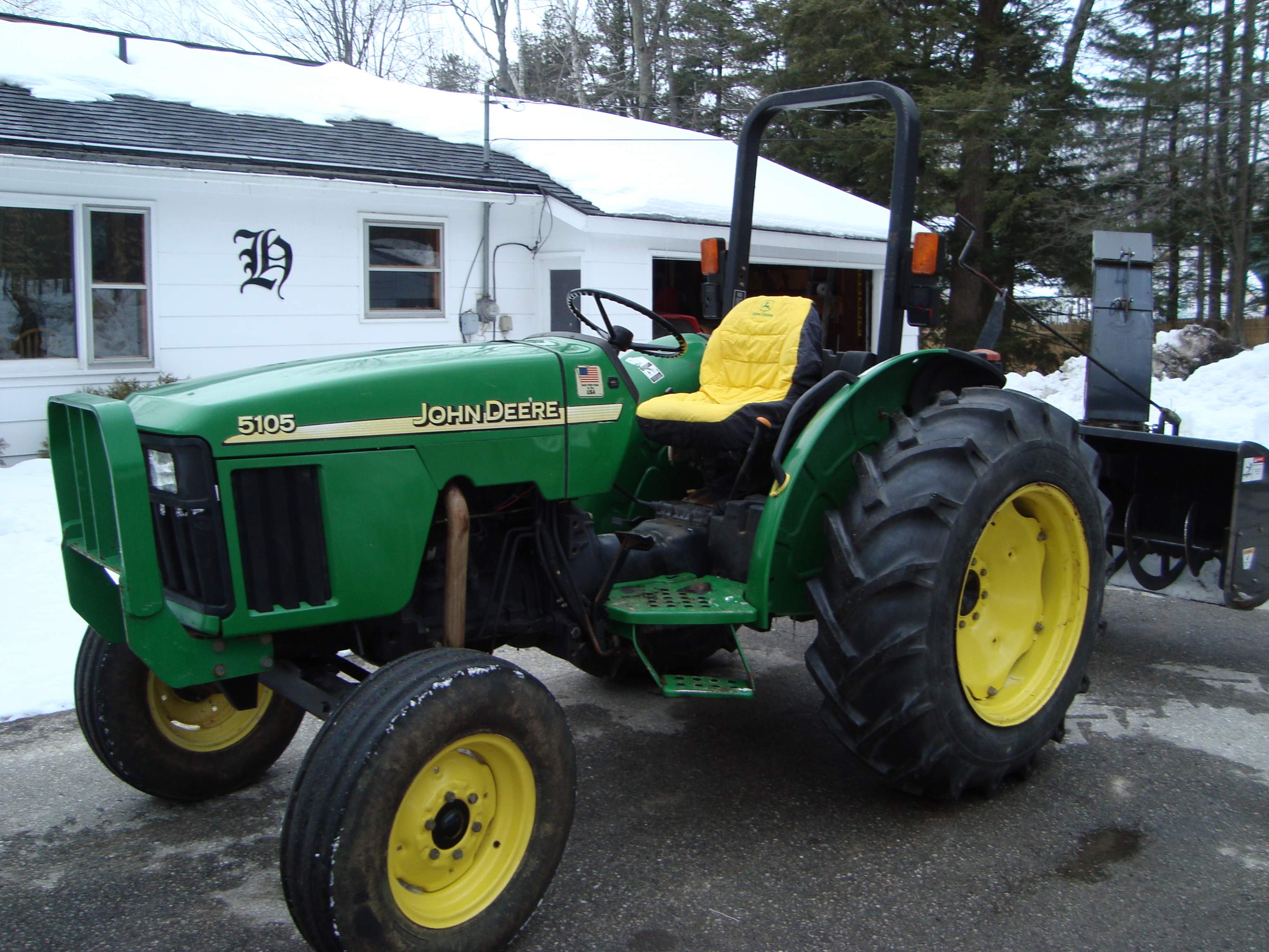

JD5210....I have a block he DSC06356.jpgr LV150155 for my 2004 5105 John Deere tractor. Where do you install it...I was told on the left side? Below is a picture of the tractor with Erskine snowblower attached. Ed

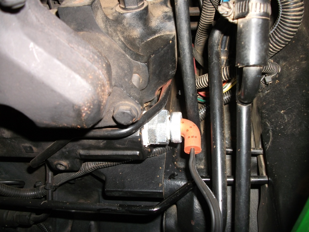

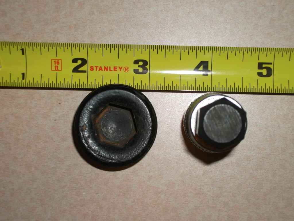

Ed, I have attached a picture (from CTM125 manual) of where it goes and a picture of the plug. It is located on left top of the back of the engine. My required a 5/8 allen wrench to get it out, there is not a lot of room back there between the back of the engine and the firewall. Do not know if it helped, but I put penetrating oil on it for a few days prior to getting it out. It came out very easy.
Do you have the instructions the center picture on the back shows where it goes. If you do not have them let me and I will scan them in and e-mail them to you, if you will send me a private message as the scan maybe to big to post.
Do not try installing without the instructions. On the element twist it to the right til it stops, then twist it to left til it stops, then center it between the two stop points.
On the allen wrench, I found a 5/8s at the auto part store, but it was to go on a socket wrench, there was not enough to get it in. Hate to share this, but I had to put a small pipe wrench on the allen socket to get it out.

JD5210....I printed out the file where the plug goes. It apparently goes inside the side panel...See photo. EdJD left side panel.jpg
   / 5105 Won't Crank #18
Ed, yes, you will need to remove the left cowl and raise the hood as far as it goes.
