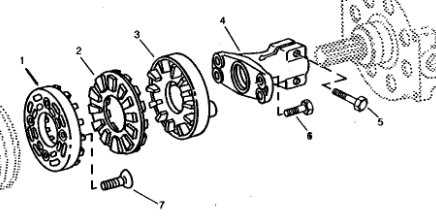

I have this 510C that has developed a noise in the hydraulic system. All fluids and filters changed. Have not checked the screen yet. When the tractor starts and as long as you are not using any implements there is a loud constant growling noise. As soon as you fully open any implement valve, backhoe, stabilizers, loader etc. the noise pretty much stops. Quiet as a mouse. Driving does not affect the noise. I used a stethoscope and listened to the main pump on the front of the crank and the other pump there and they appear to be quiet. With a noise like that I would have expected them to be noisy and the cause. What other things can cause that noise when controls are open center? You hear it louder in the enclosed cab that you do outside. Just trying to give you all the info I am seeing... Thanks for any input/thoughts...

If everything is functioning normally, I would suspect a bad pump coupler. Item 2 is a rubber coupler between drive discs that can wear out. Can also have loose splines in driveshaft #4. 510c pump coupler.PNG
   / 510C hydraulic noise #5
jd110
Have you witnessed the newer type drive coupler such as you pictured causing this noise similar to the older drive coupler with the round bushings? The reason I ask is my 4255 has over 11,000 hrs on original drive coupler with very little nose.
Thanks,Jim

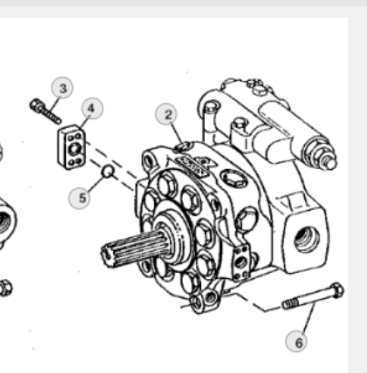

Tractordata states a JD 510C has closed center hyds & I think from viewing parts catalog 2065 that the 510C hyd pump is a closed center pump very similar to JD ag tractors with closed center hyd's.
Noisy closed center hyd's correction requires some very good thorough diagnostic procedures by someone with a good understanding of how the CC hyd system should operate IE not a person that is just a parts replacer.
