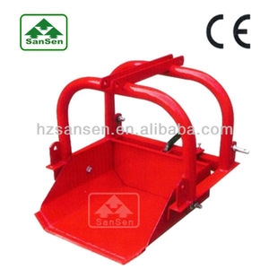

I'd better attach a picture of a 3pt dump bucket. They are almost unknown anymore.

Yes this is the bucket I am using.

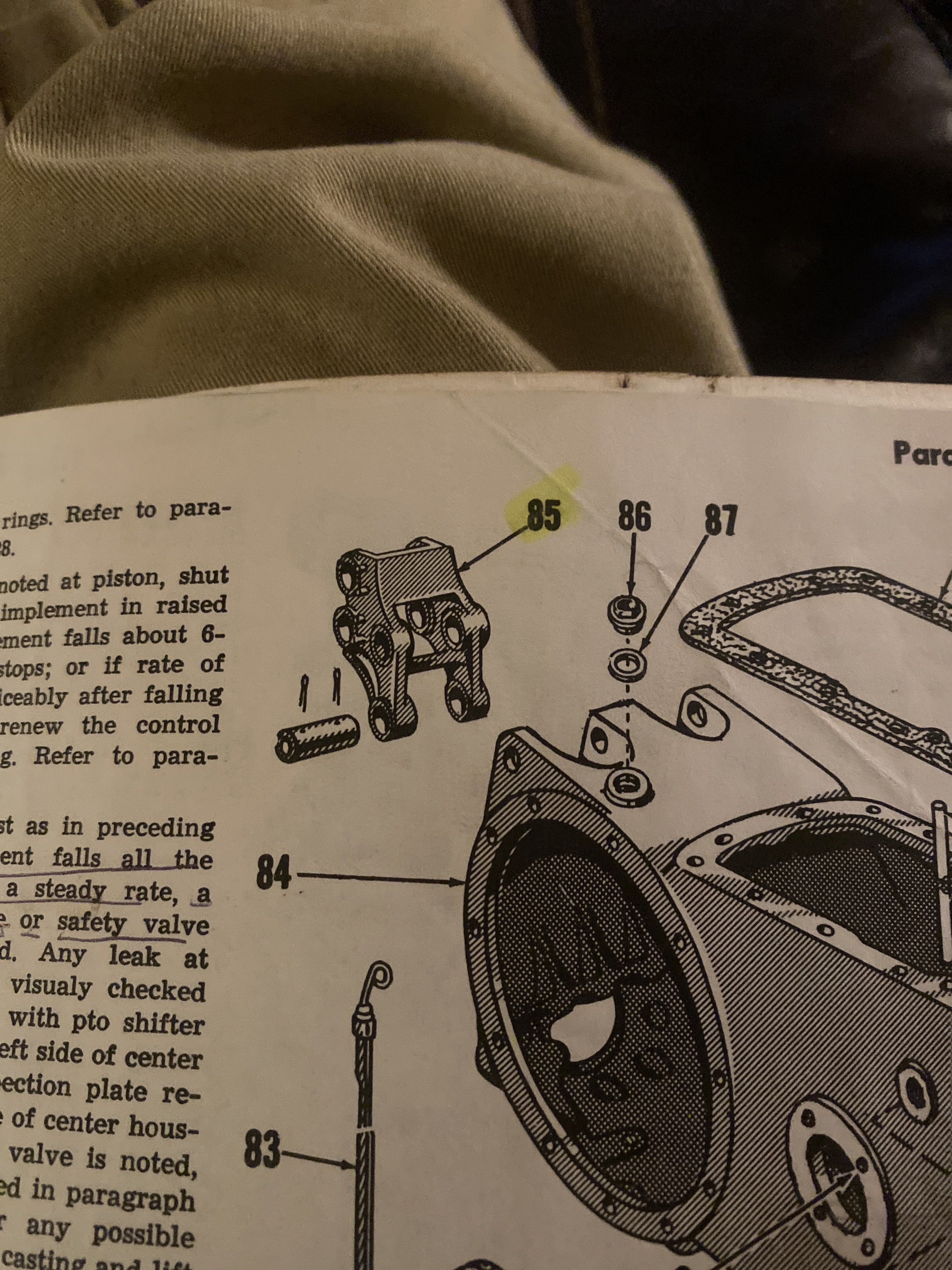

I am in the top pin hole of picture I attached below of the rocker it is oriented as the picture
I will move it down one.
Since I am dumping loads on top of loads with the bucket it does have a tendency to push the lift arm up higher. As the bucket flips & dumps on these mounds it will force the arms up some.
Once when digging up a load I hit a root pretty hard. It jammed up everything with lift arms down & bucket half way flipped. It took a bit to get it unstuck.As I think about it this seems like when issues started.
Yes the "pond scoop" is not seen much. Got a deal on 53 jubilee. Came with scoop, disk, breaking plow, cultivator, bush hog, box blade, 2 row planter & a boom arm all for $3000 back in 2020.
You should be using the bottom hole with the pond scoop. The top hole is for use with light draft implements like a cultivator.
Using the top hole and jamming the scoop is, IMHO, what has caused your problem, it has probably bent the internal linkage by putting to much force on them. It has happened before to others because most do not understand the use of the different positions/hole of the rocker. I know I was just as guilty of using the top hole before I fully understood.
