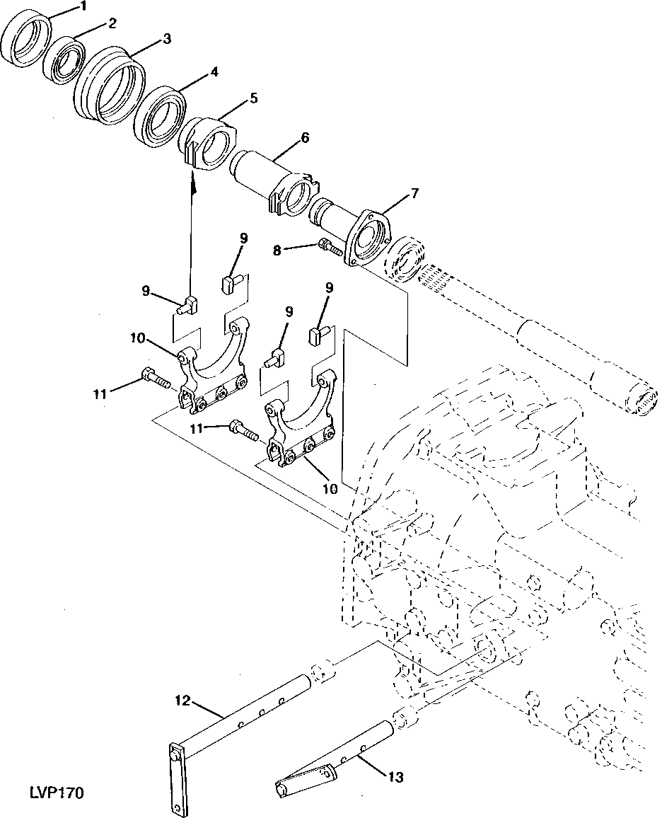

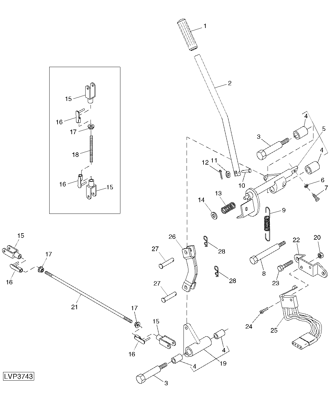

The pto control mechanism on 5000 series reminds me of a '61-'65 2010. I'll still vote for 55 series.
