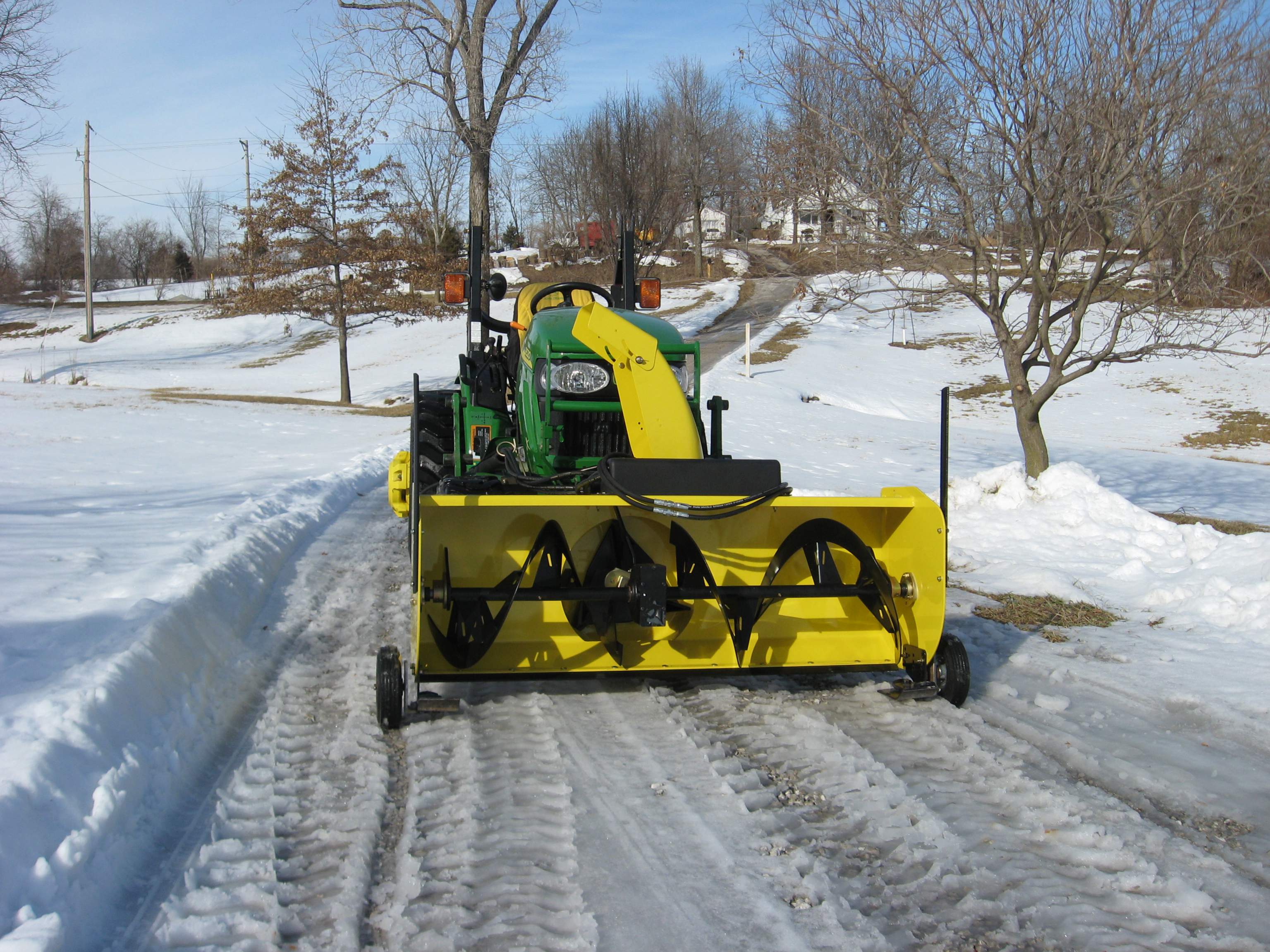

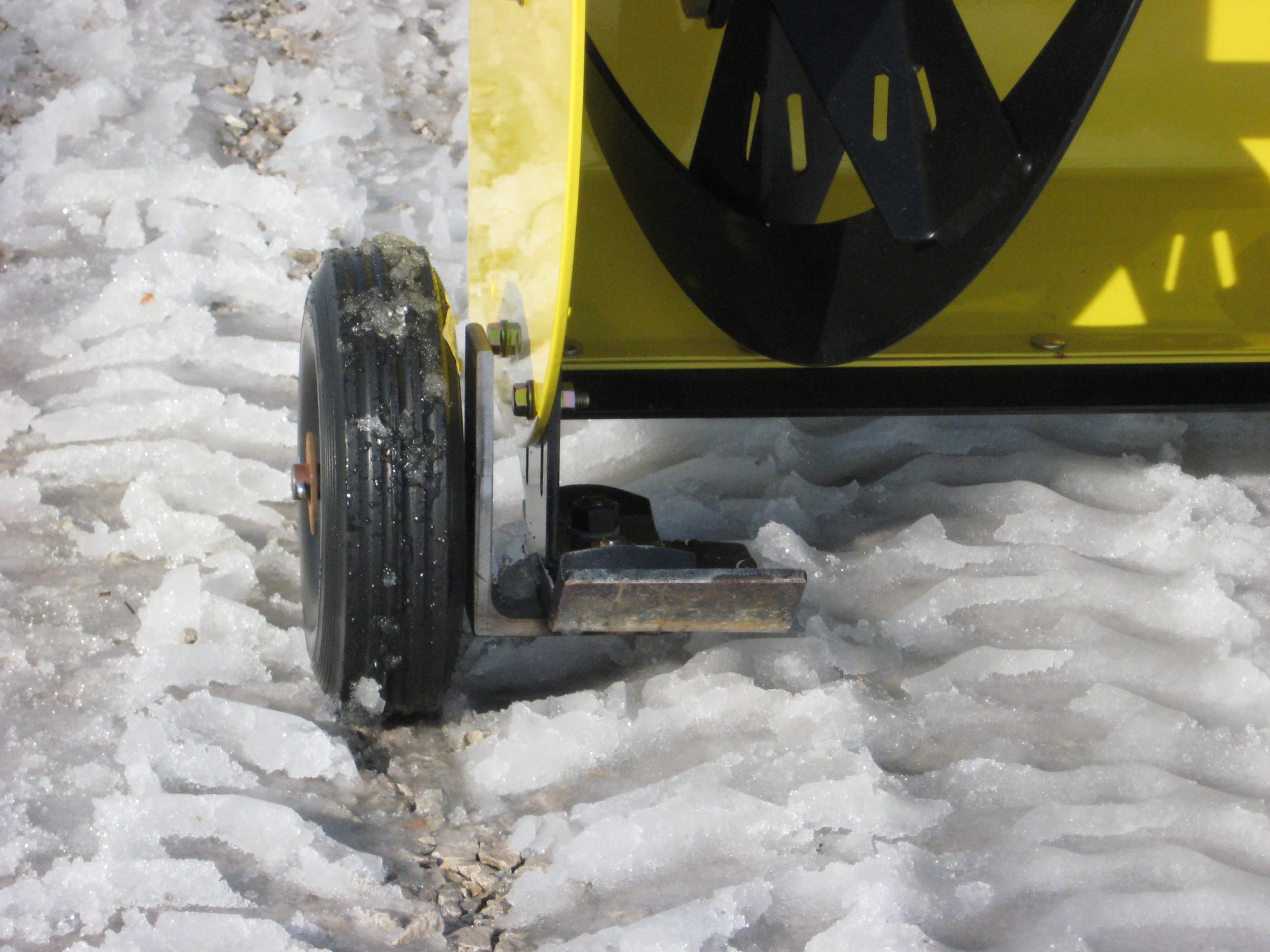

I tried increasing the area of the shoes as described and it still dug in, so I decided to add wheels to large angles that bolt to the bottom of the shoes. Seems to do the trick. IMG_3181.jpgIMG_3182.jpg

I tried increasing the area of the shoes as described and it still dug in, so I decided to add wheels to large angles that bolt to the bottom of the shoes. Seems to do the trick.View attachment 298075View attachment 298076
Never seen a set-up like this before, but hey, if it works good for you. :thumbsup: Up here the ground is frozen solid usually from Dec. to end of March, so not a problem. Have to say that I'm not to sure of the position of your hydraulic hose in front of the auger. :confused:
   / 54 " Blower fan observation? #28
Yeah looking at those hoses made me a little nervous too :D

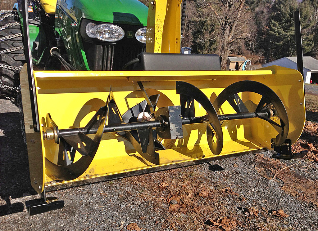

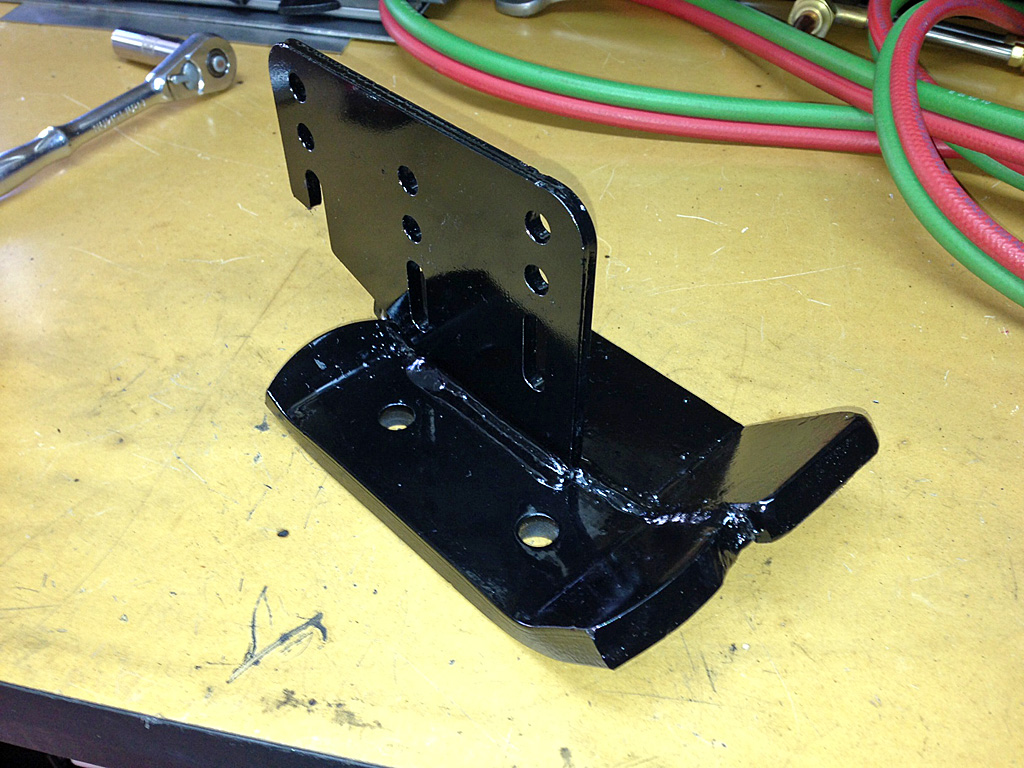

I installed the new blower shoes today. I guess I will have to wait until our next snow to see if I made any improvement. Below are a few photos to show what the new shoes look like. I simply added an additional skid to the side of the existing skid.
BTW, does anyone know why JD put the two holes in the original skids?
I don't KNOW this but they may be locating holes for the welding fixture when the two pieces are welded together
