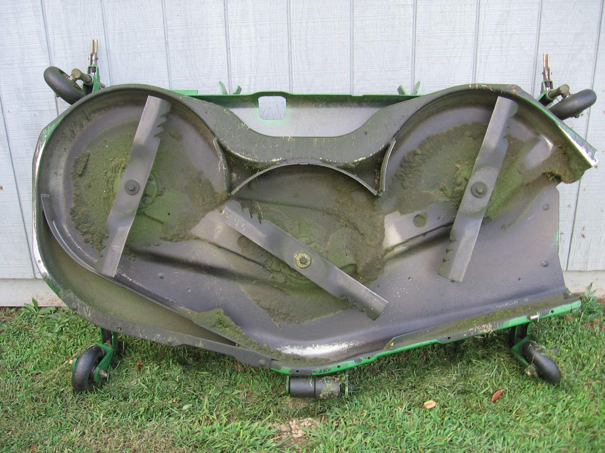

I installed my set yesterday and so far I like them.
These are NOT thicker than the JD blades I have been using. They are actually thinner and come with a 3/32"spacer washer to compensate.
They are wider and measure 20 7/16" long vs. the 20 1/2" listed. These are for a 60" deck. No problem fitting the deck.
This is the JD M141785 vs. the Oregon 396-734
My 445 without the chute throws grass out good anyway, but with these blades and dry grass it shoots grass out 12 feet, no joke.
The blades also do a good job chewing the grass up.
My mower and myself was covered in small clippings after mowing this time.
I can tell these are harder on the engine, but not a problem except it seems to be burning more gas.
Also the blades are some louder from the whir created by the gator fins.
I don't know about wet grass yet or how they keep the underneath clean or not.
If you run over bare areas the blades do suck up dust way more then the other blades.
But for green summer grass I love them so far.
/ 54" extra edge mower deck #30
I don't know what blades that you were using from JD, but my G6 blades are 1/4 inch thick and 3 inch wide. I don't think JD makes a thicker blade then that. But that doesn't matter, sounds like you got some good blades that are working for you.
/ 54" extra edge mower deck #31
After reading the comment above from JDTank I have to wonder if I got the real Gators.
They did not have an alligator stamped in them and the end fin is not turned up; if I understand his note.
This is the link to what I ordered. The number 396-734 is stamped on the blade.
96-734 John Deere - Gator Mulcher 3 In 1 Magnum Mower Blade - 20-1/2
Are they some kind of knock-off?

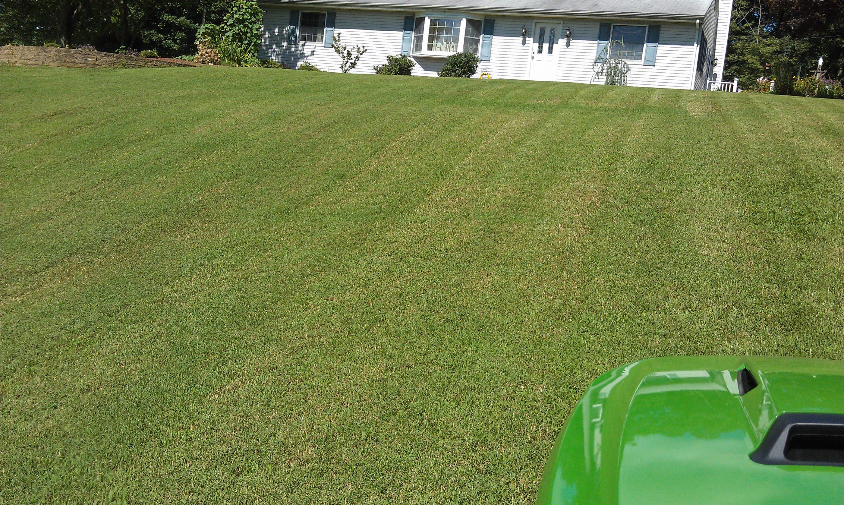

Have the 54HC. I Have adjusted leveling points using manuals specifications. Using the deck location and using the blades from sides and middle front. Have depth gauge at 3 inches. Front middle blade at 2 3/4 inch. My problem is the deck seems to cut a deeper blade cut on right side. See pictures. I cannot correct this. What causes this. Blades, deck? 16 hrs on deck and tractor. Any you folks have any idea please let me know. View attachment 332114
Not sure when you posted this comment. I have a x758 with the 54HC deck and am having the same problem. Have adjusted the deck many times, the last time I leveled the deck front to back and left to right at the same height; not the way John Deere recommends, but it seems to have helped. Still not as level a cut as I have had with other mowers.
From you comment I am thinking John Deere may have a design problem. Like I said I don't when you posted this. Have you resolved this problem and if so what did you do?
