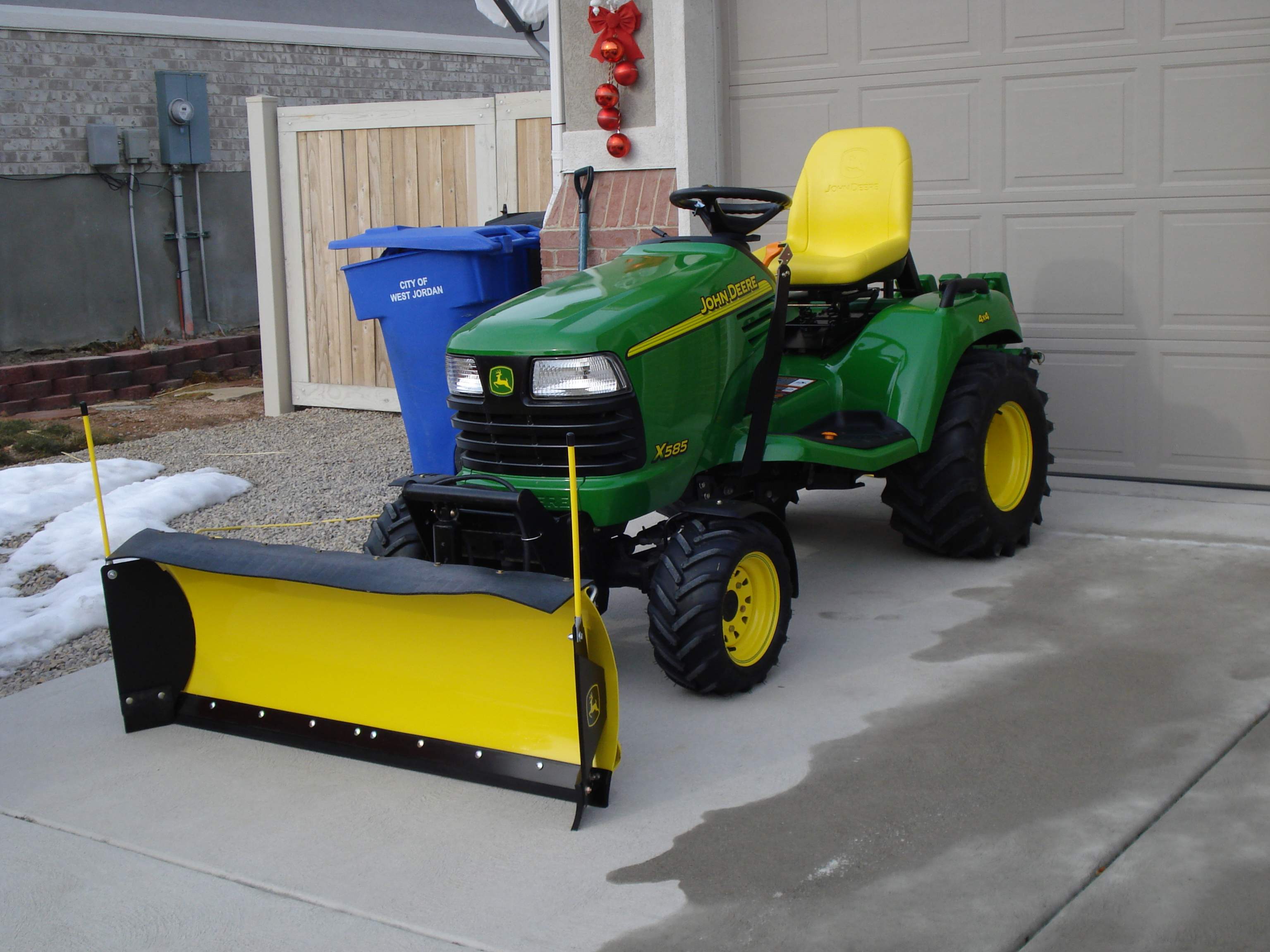

I have a 1026R unit that measures approx. 45" wide - If I was to use the Deere 54" blade angled at 30 degrees, it would clear about a 46.5" path. I know a wider blade would be better and I've searched for 60/66" blades to no avail.
After reading most of the discussion topics related to the Deere 54" front blade, the only issue I can find is the blade isn't wide enough. I can't find anyone complaining about the trip springs, hitching or unhitching, weight, or anything else.
Have I missed any another problems with the Deere unit? I have a couple of resources that could weld on extensions for me after I get the package from the dealer. I could always hand a shovel to the wife so she could walk next to the tractor to help with the overflow...
I'm running R3 turfs and don't expect any traction issues - same set-up I used with a 4115 a few years ago.

Steve the 54in blade was designed for the normal run of the mill gardern tractors like the old 300 series and some of the 200 series gt's as well. Your tractor is a touch bigger then these models so it really not designed for your size of machine. JD does make a larger blade but I cant remember exactly what size they are sorry. I have seen a few 54in. blades where people have put on "wings" to help with the width of them though. Perhaps you could take it to a fab shop and they would make you a couple to get it a little wider to help with your tractor.... Gary

As far as I can tell, the 54" should eject the material far enough. The pivot point is a good ways back from the cutting edge, effectively throwing the blade over more. I haven't used mine yet, but I think it should work nicely.

This is my BX1500 with a 60" front blade with Hyd lift and angle.
A 54'' blade is to narrow for a S-Compact tractor.
JD misses the mark by not offering a 60'' mower .

That is the only complaint I have ever heard-they are not wide enough. JD does NOT make a wider one that will fit without fabrication. If you can get wings made for it then I say go for it.
