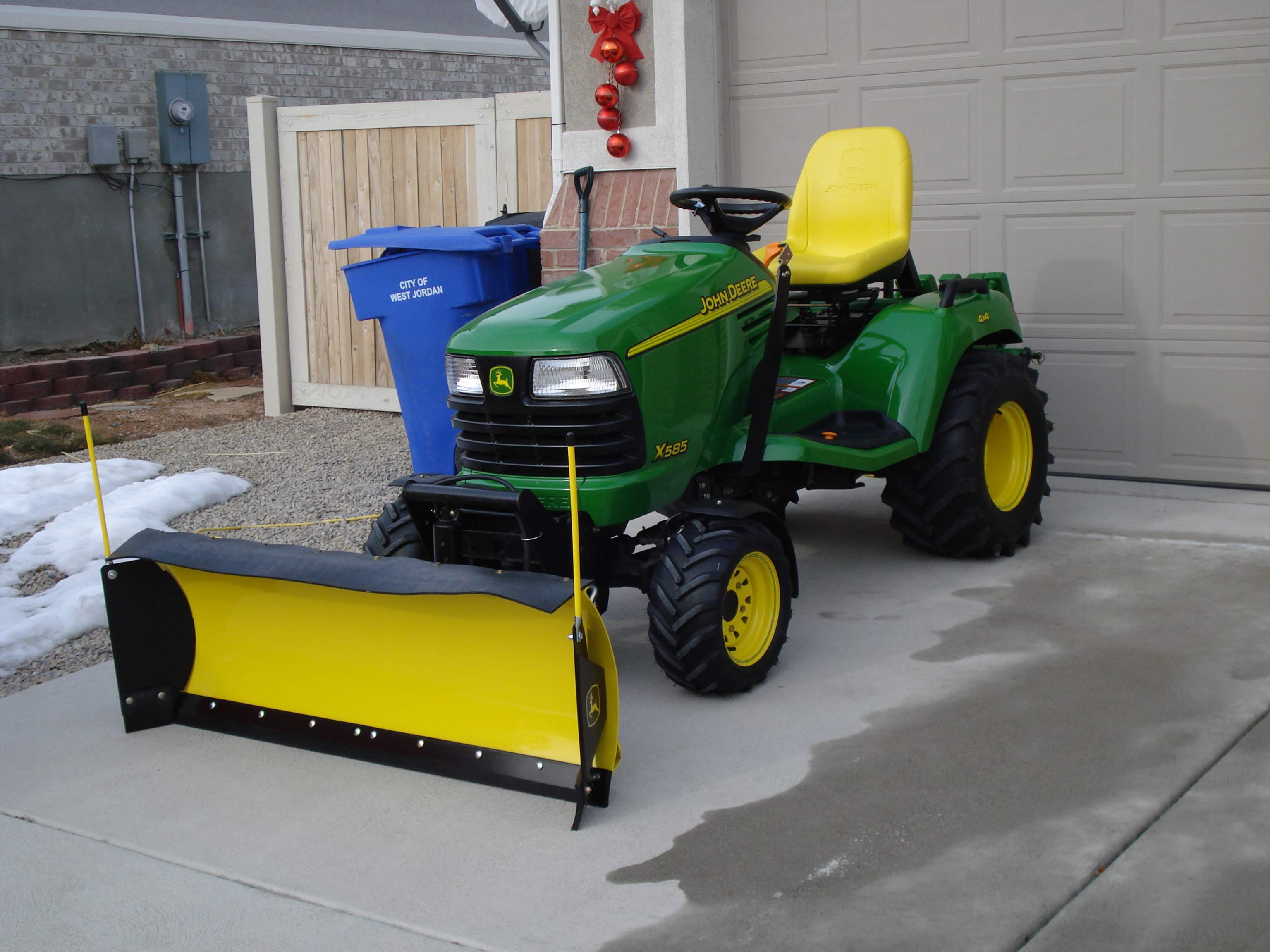

I had the same problem with an X585. I ordered the Cycle Country plow wings and now the blade is 60" wide. No more running over bladed snow.

I bought my 54" blade in 2004 and at that time it was sold as a dozer blade and not a snow blade for the 2x20.
I would say it is not wide enough and the curvature is not enough to roll snow off the blade. It pushes verses rolling the snow off and this will cause you traction problems. My experience is that it is good for dirt but find something else for snow.
