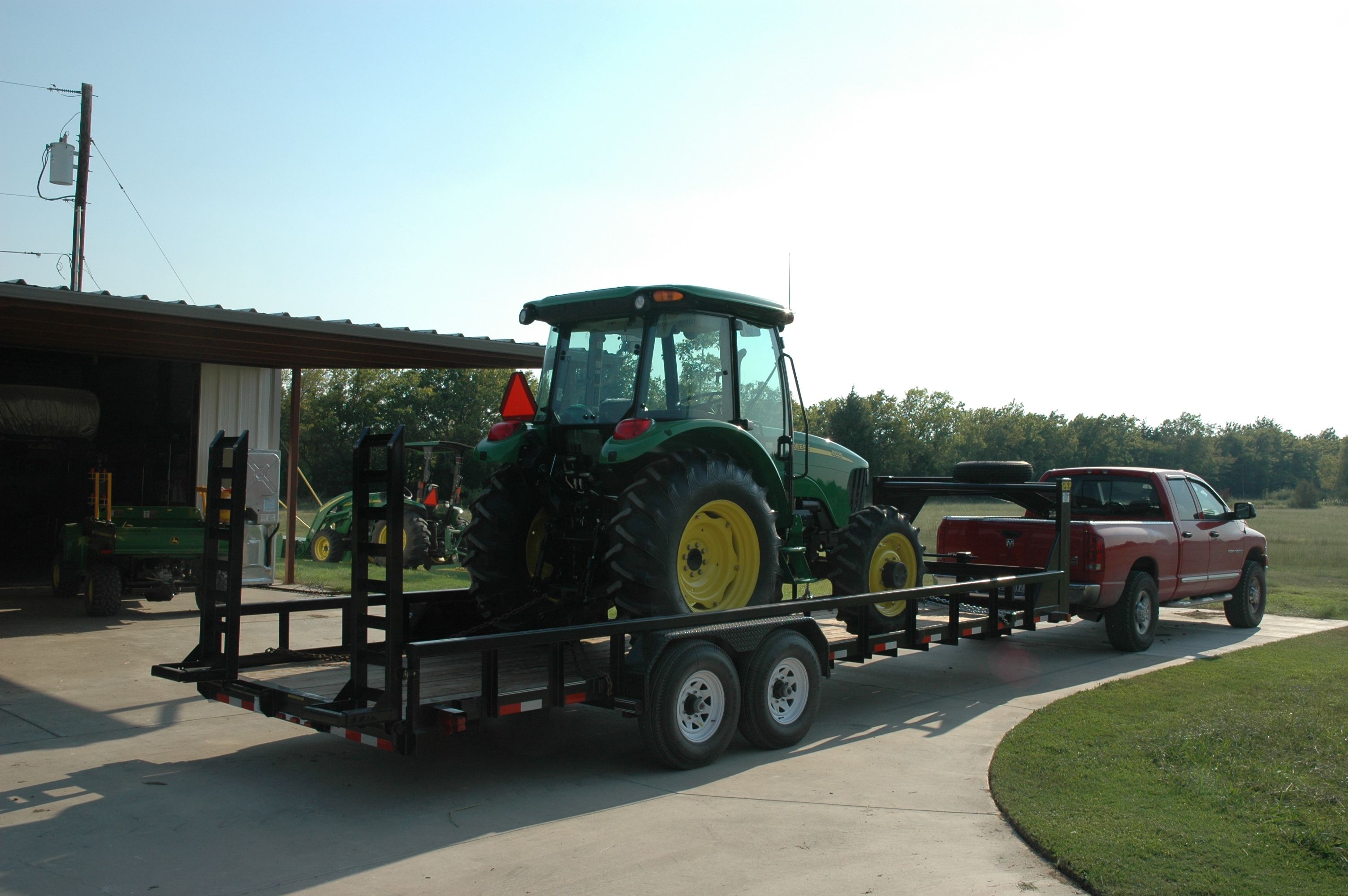

Here is a pic of my 5525 when I brought it home on a 24' trailer to put things in perspective.
D.

Thanks much for that pic. That does indeed put it in perspective. I will know tomorrow for sure what I am looking at.
