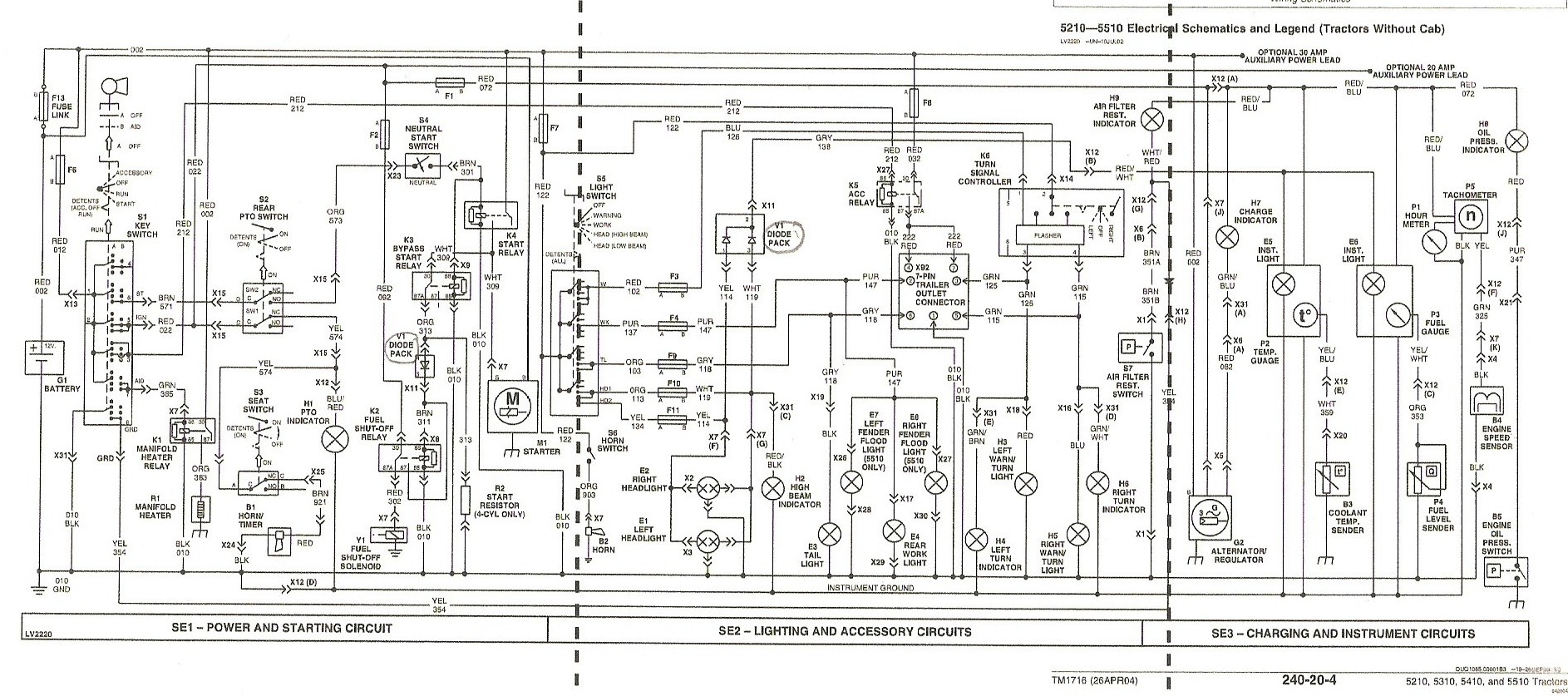

I can't find a wiring diagram for this online. I'm assuming there's a few relays and safety switches that could be the problem, but without a wiring diagram....

I have attached a wiring diagram for the 5X10 tractors. I think it should be close to your tractors wiring.
For the 5X10 the safety system is PTO in neutral and transmission in neutral or park. Components that could be bad are start relay and start bypass relay.

I went off the wiring diagram above. I checked the circuit at the Neutral safety switch first. I unplugged it and tested for power going into the switch. According to that wiring diagram, I believe, the neutral switch comes after the PTO switch in the series of ignition safeties.
