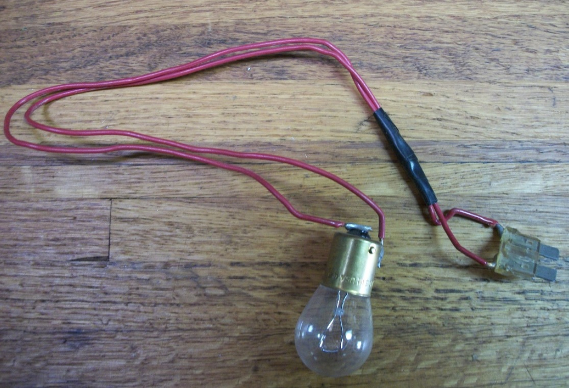

My #1 question would be why did the fuse blow?
My understanding is that when the sensor fails, it shorts and blows fuse. Never heard of one un-shorting. (Maybe it un-shorts when temps get higher? Anything is possible I suppose.)
   / 5425 won't start - nothing #14
Rig a 12v lightbulb to plug in place of the fuse. If there is a short, the bulb will be lit. When the short is found, then the bulb will go off and is likely safe to replace a good fuse.

It blew fuse with the sensor unplugged. Does this indicate a short?
   / 5425 won't start - nothing #20
Think that is true.
Plug a 12v light bulb into the fuse slot. Then look for the short. When you find/fix it, the light bulb will go out and then should be safe to put a fuse back in the fuse slot.
