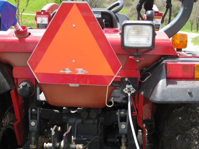

I also have plastic barrel for diesel fuel. It has two bungs. One has the same thread as the steel barrels. The other has very coarse thread. I bought 12V Northern Tools pump and filter that is permanently mounted on the barrel. The pump is powered from the tractor when refuelling. The barrel is on a dolly now so I can pull it to the tractor.

So I decided to purchase a 55 gallon plastic food grade drum to hold my offroad diesel (beats going in to town every other day).
Well, it ain't all roses. The pump head keeps popping out of the bung.
1* I have tried it in both holes and it keeps popping free. 2*Now this is my second one, my first was a cheaper plastic pump that was donated to me by work.
3* is it my plastic barrels?
4*Should I try to find metal ones or is this just how this works.
5*Also, the friggin HF pump the pipe that goes through the bung adapter is not water tight.
Carl
1*You need to use the fine thread.
The coarse is to thread a vent into the center of the cap.
2*Still should have worked with the proper fitting on the drum.
3*No
4*Stay with the plastic.
5*The problem is there is no pipe fitting to screw into the drum after removing the cap .
Worse yet nobody makes such a fitting .
I solved that problem by building my own.
Fitting
This end stays Outside of the drumb.
This end goes inside the drumb
This is a picture of the fitting installed on the drum
Without this fitting it's basically impossible to successfully get the suction tube through the top into the drum and acheve the desired results.

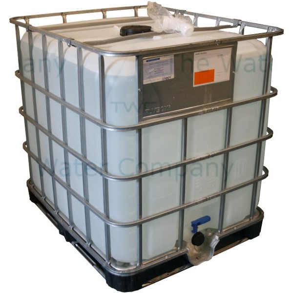

Have you thought of gravity flow from an IBC?
On and offloaded with forks, the valves are robust, easy to fab a platform, and it would be easy to plumb a Goldenrod water separator filter between the valve and the fill hose.
