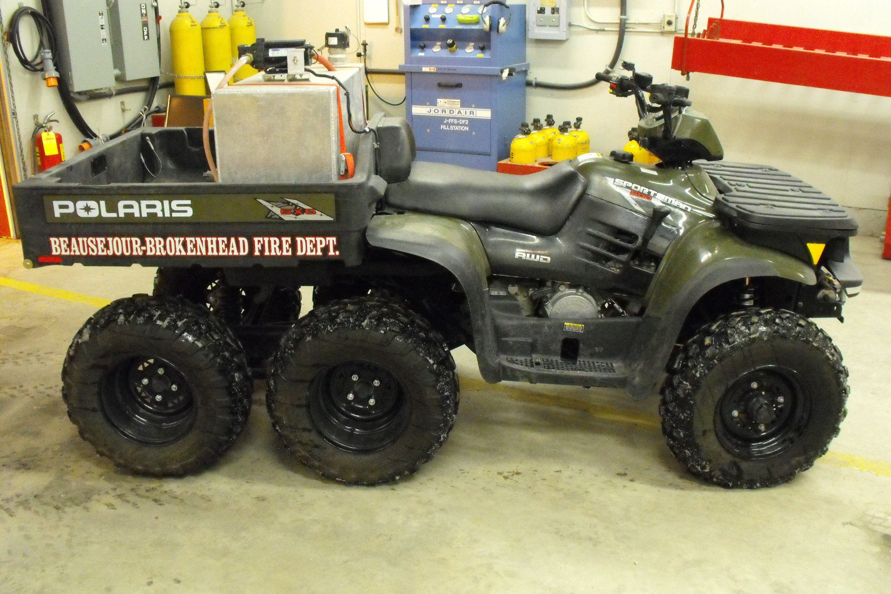

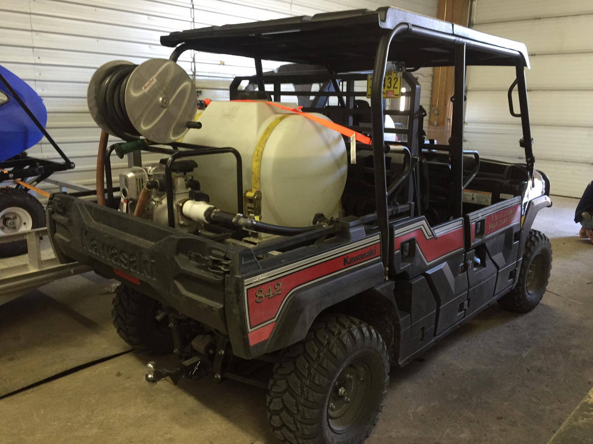

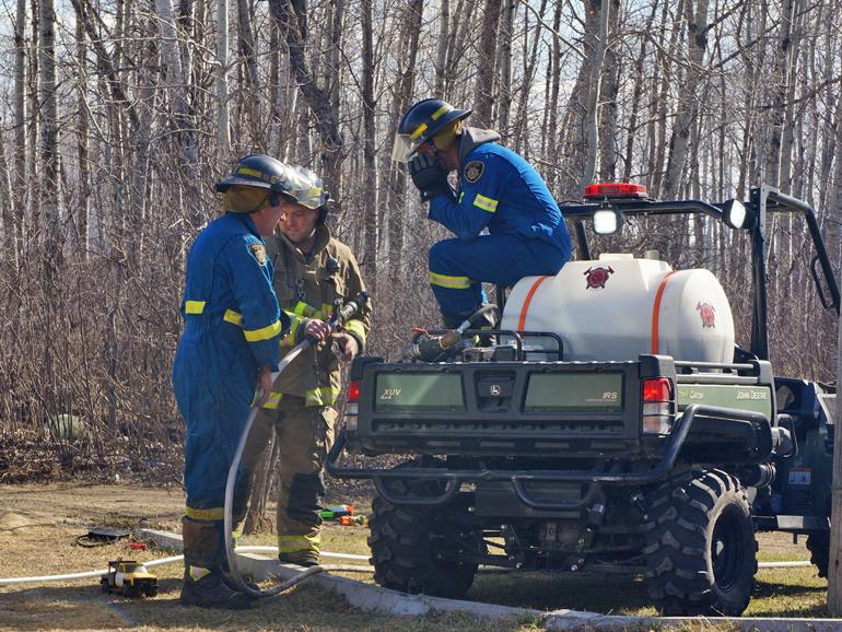

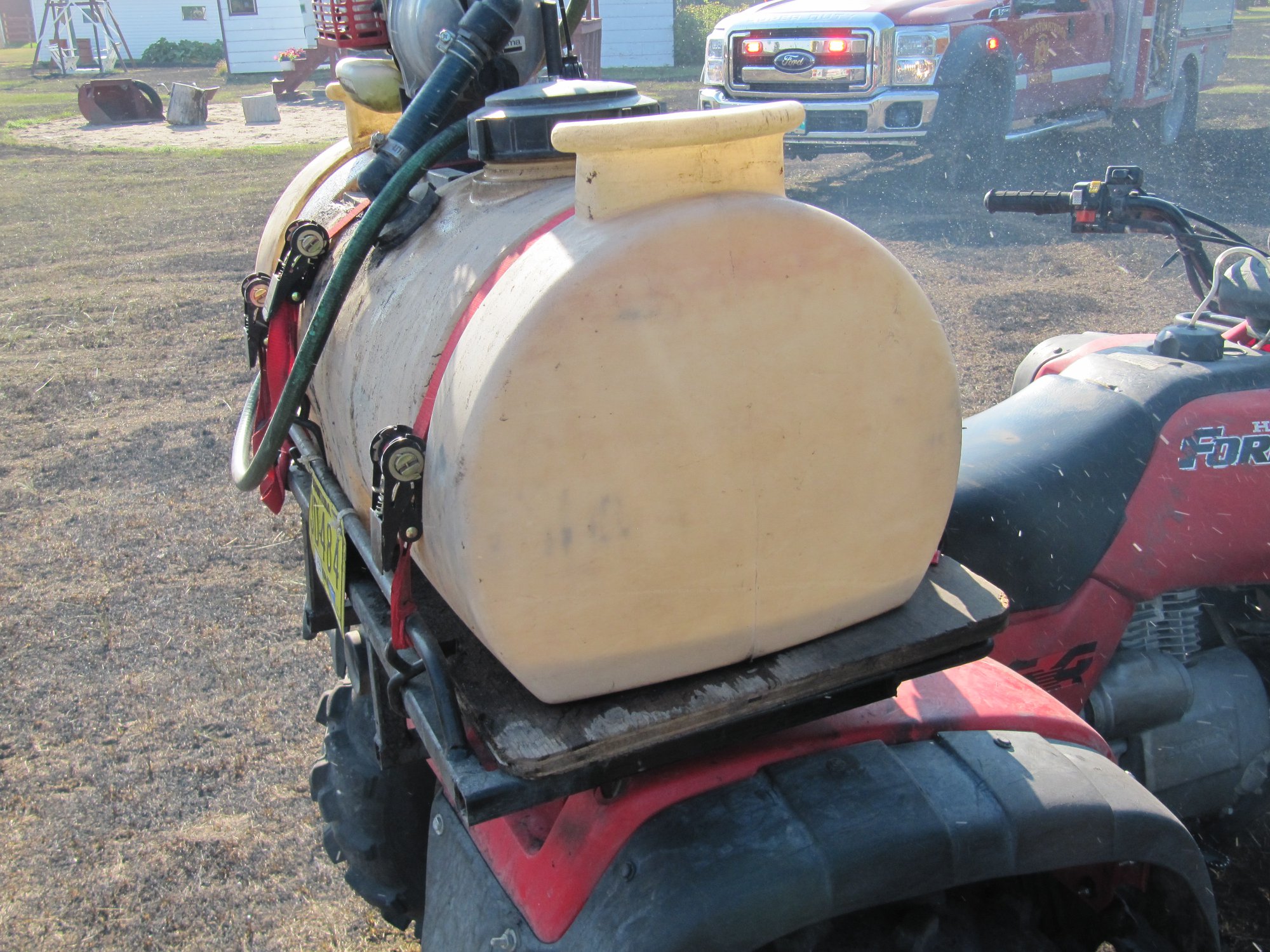

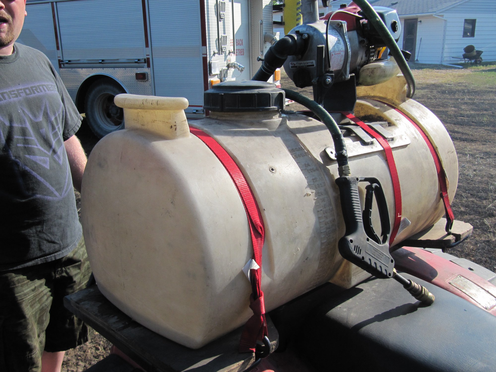

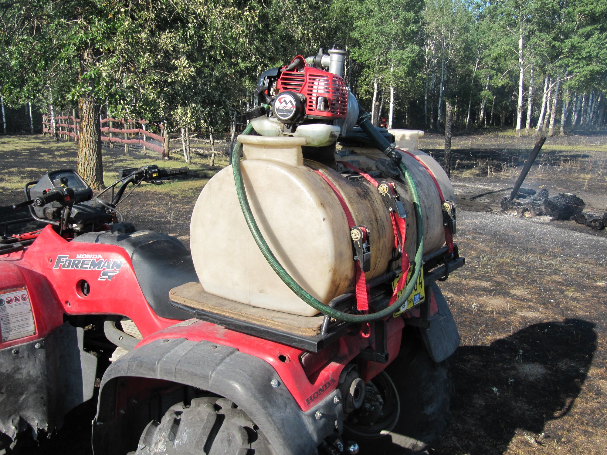

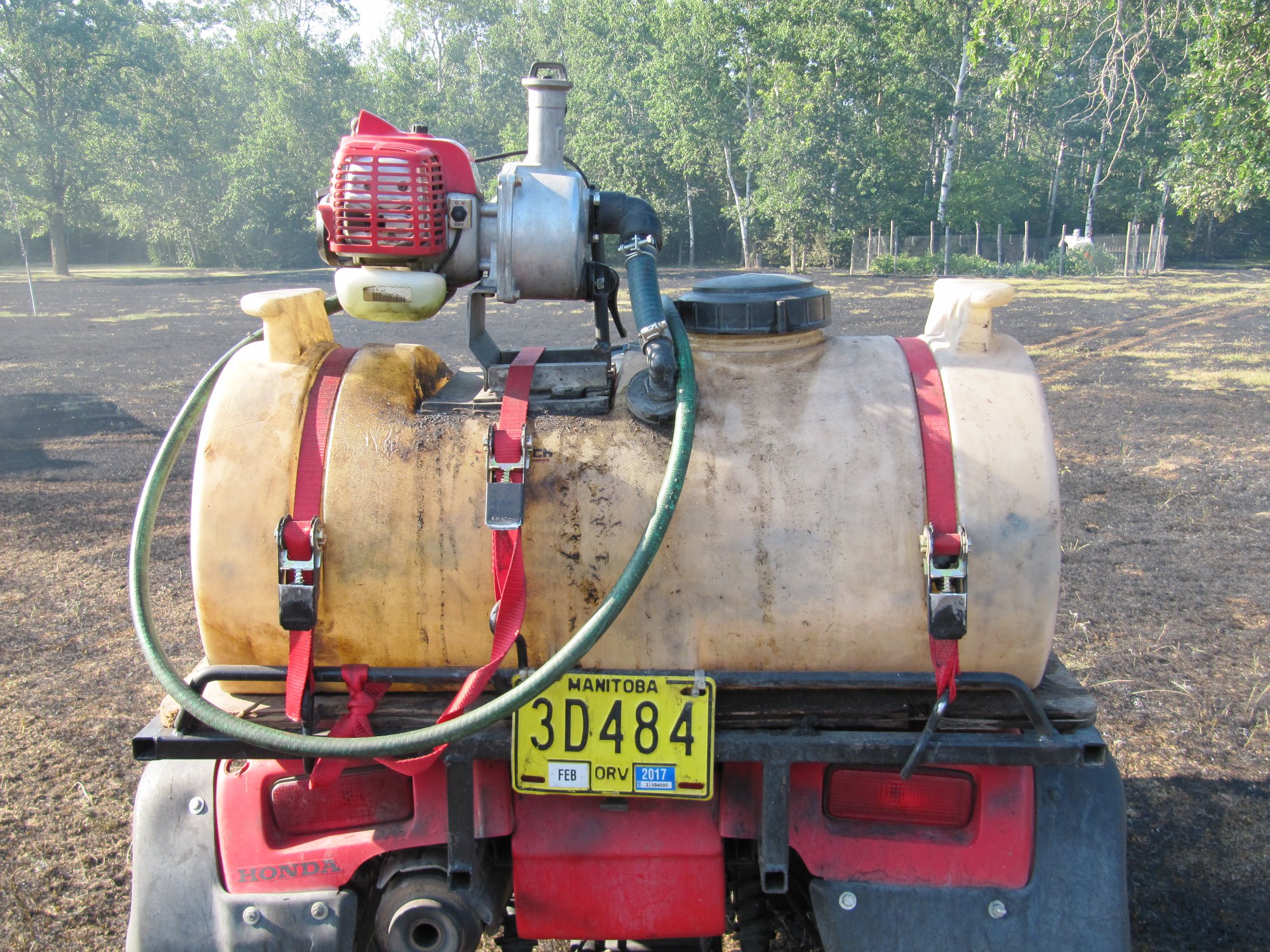

Thought I'd post some pictures of some other set ups I've encountered. The home made ATV set up is used by a nearby Fire Department for fighting grass and brush fires as it can get to places that a 1 ton or 3/4 ton can't and because manpower is always at a premium and we don't get much help from the Provincial government unless a fire is on 'crown land', the ATV or sometimes UTV can do the job of ten or more people with backpack pump, brooms, shovels and pulaski's. This also depends on the severity of the fire of course etc. etc.
This particular Fire Department has three ATV's all equipped the same way and they use a sort of hit and run tactic knocking down what they can and where the larger trucks can't get to, running back and forth usually refilling from a tanker or pumper. My Fire Department didn't have one but these guys that do have them say they do an excellent job in most circumstances. As you'll see in some of the pictures some Departments tried using little trailers to haul larger volumes of water but are now switching to carrying water on the backs of the machines as the tank trailers can be difficult to maneuver in thick brush and difficult to back up in an emergency as you can imagine.
