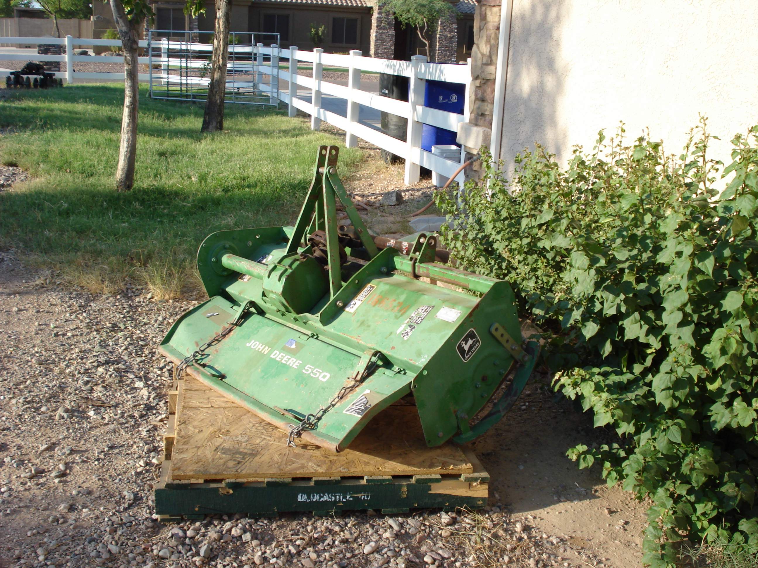

Just picked up a 550 tiller on Craigslist for $400
see pictures attached

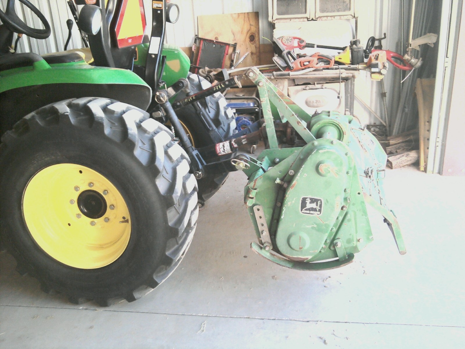

Sure works great on 3320
Has plenty of power to run it - even in hard AZ soil
Would like to give it a paint job

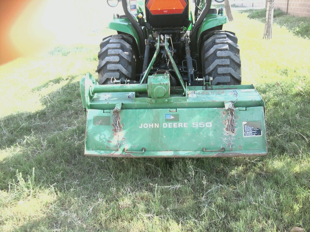

Previous owner backed into something and bent the rear flap
Does anyone have an idea on how to straighten the rear flap
(see last picture)
Also
Does anyone no what the going price for a 550 tiller is
Hope I did not overpay
Any advice would be appreciated

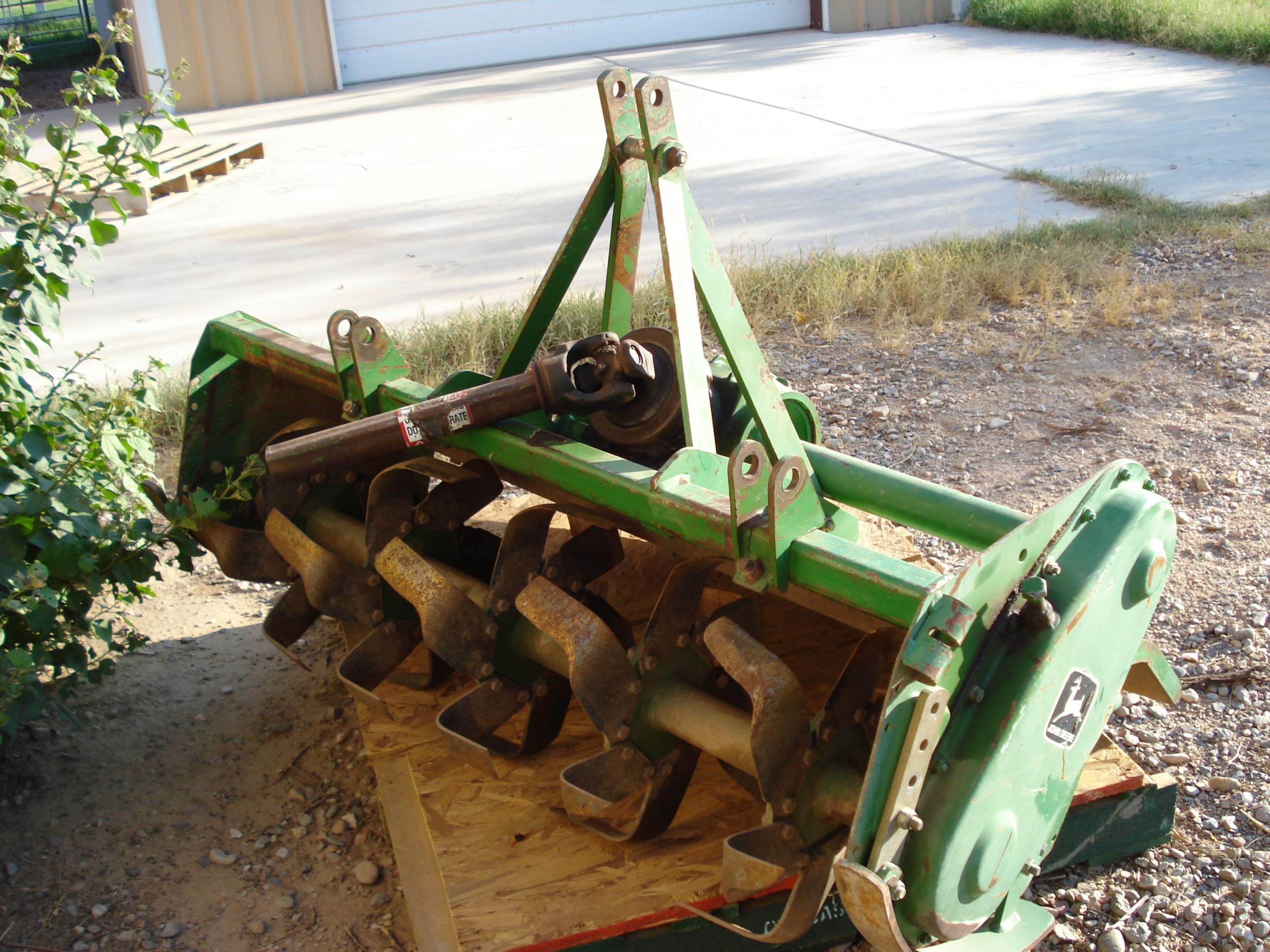

You got a good deal in my opinion. I woudn't worry about that tail gate. I tilled with the gate up some on my 660 and I think your tail gate will work fine like that. Might want to get some paint on it. Your tines look like originals and the outside ones are getting pretty worn. After another year or two of use you might want to think about new tines. You'll be amazed how much better new tines till. I see you have the slip clutch on the PTO exposed. If it has set outside chances are the clutch plates have rusted together. It would be wise to tighten down the slip clutches bolts to free up the plates for a bit then back off the nuts to till. If you can't figure it out you can take it to a JD dealer and they will be glad to show you what needs doing. Contrats on a nice find! I just traded in my 13 year old 660 and a dealer allowed me $1900 trade in value for it. You done good!:thumbsup:

Very good deal at that price. I picked up a non-Deere 60" for $500 and know it was a good deal. I would have paid twice that for a Deere. But the non-Deere has done well for me the last two years. The rear lids get bent up when one forgets to raise them and backs up.

You mentioned the slip clutch is "exposed"
Did it originally come with a plastic cover?
The slip clutch still works - I hit a small rock and the tiller quit turning
Shut the pto off, cleared the rock and turned the pto back on - worked fine
I can see the slip clutch is a great feature - much better than shear bolts!!!!

Still would like to straighten the rear flap before painting
I was thinking about replacing the tines as well
(if they weren't too pricey)
Does anyone have a good aftermarket source for tines?
