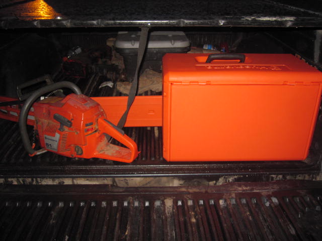

Your 51 is MINT. Mine is filthy by comparison.
On the AT saws, they do run better and better with each tank. I must have close to 12- 14 tanks through mine now. Every once and a while it still (slightly) bogs out of the hole after sitting at idle for a bit and blows a bit of black smoke. It seems to happen on colder days (when the temps swing from warm to cold) so Im going to say it's still learning. I also changed fuel, and CAREFULLY measured both the fuel and oil for the mix and that seems to have made a large improvement in performance. I dont think these saws like extra oil over 50:1 or fuel that might be a bit stale.

Fresh fuel is very important and a bit more oil is no problem. I run 91 non-eth and 40:1 XP or Stihl Ultra oil.
MM is no problem for the auto tune, it will just compensate for the extra flow...

I wallowed my exhaust out today, using the Dremal with the conical burr. It was narrow enough to get in between the base of the heat deflector and the top portion of it with out damaging it. I was able to keep the hole back pretty far under the deflector plate to keep heat off the brake handle and keep the spark arrestor screen. It does not seem any louder than stock, throttle response seems better, but still has a high end stumble. I will have to run it in under load to get the real world comparison. I took some pictures of the dremal burr for reference and the exhaust. I will post once I do the real comparison.
It was a very easy mod, and if its good, would be the easiest 4 horses I can remember. I figured there was a lot of dissasembly, but the brake handle was out of the way for the 5mm T handle Hex, I think it took more time for the paint to dry.
UPDATE: It runs like it should have to begin with, Its like a new saw, no hesitation, instantly on the pipe, and a top end I can'T find the limit too, I must say...discretion should be used on the top end, particularly under no load as I am sure you could throw the rod or worse, thanks for the turn on.
I had read the mods prior to buying when researching the product,(Seems all there was on the web, combined with youtube vids) I really did not want to tear into anything on my new saw. However the mod was simple enough, and I was past break in, besides if it did not work out, I could replace the pipe. Glad I did it. My hole is tear drop shaped and a little less than .50" max in diameter at its largest point.
