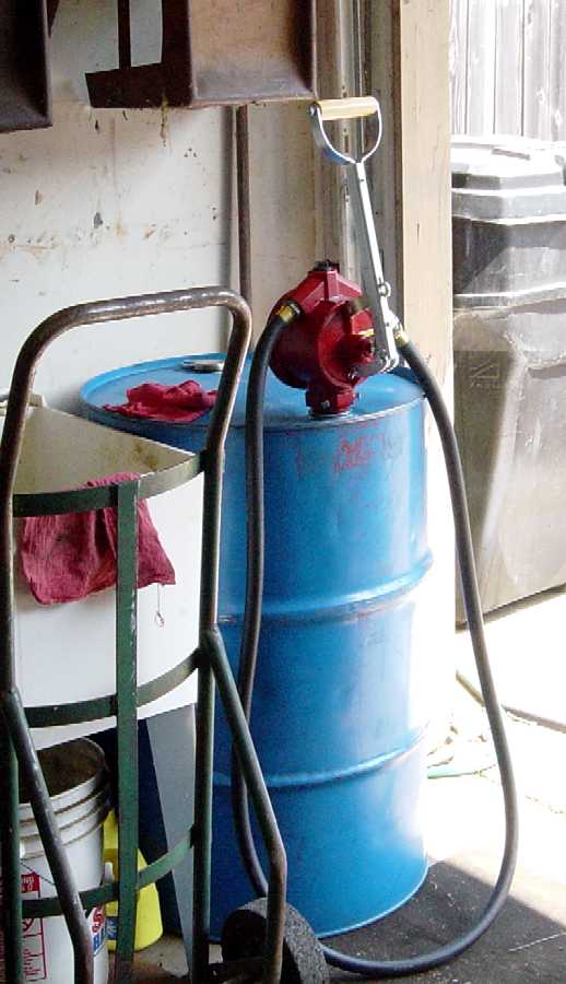

Well got the drum cleaned out and the pump installed and it works awsome! /forums/images/graemlins/grin.gif Can fill the tank very quick and with absolutly no mess! /forums/images/graemlins/grin.gif /forums/images/graemlins/grin.gif
Can anyone recommend a fuel stabilizer to put in the diesel. It will take me at least a year to empty this thing out.
thanks,

<font color="blue">Can anyone recommend a fuel stabilizer to put in the diesel. </font>
Power Service available at TSC, among others.

I second the Power Service.
Also, I didn't see (or maybe you don't have) a filter on your pump. I've seen them recommended, especially when you draw off the bottom of the tank. Keeps water and sediment out of your tractor (a good thing /forums/images/graemlins/smile.gif )

   / 55gal drum cleaning help needed. #25
nice pump, looks like the exact one I went with (second time around anyway) - tried one of the rotary ones from Harbor Freight for $20 -what a piece of junk. Made in India and not worth the cost it would bring as scrap metal. Even the threaded portions were barely fully cut and the machinging was terrrible. Clear case of you get what you pay for but in this case $20 was too much!!!!
