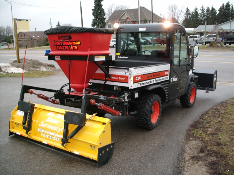

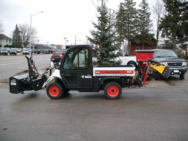

Does anybody know of this happening with the new TC's. I have just recieved on mine on Jan 10th 2008. It stopped while I was tramming it. It was still running, but would not move. I shut it down for 30 seconds and restarted it ran just fine. Have not had a problem since. The dealer wants to go over it but have not had a break in the weather. This worries me a little.
I'll be sure to mention your findings, thanks for all the info.
Just a pic of my TC with blower and rear box scraper/salter combo.
That is a nice looking setup. Where did you get the rear scraper?
What is tramming?

Tramming is a term used in mining for driving forward or backward usually in reference to a self-propelled machine.
Welcome to the forum Allan !! Had quite a bit of snow this season up in Ontario I hear.
That is a very nice set up you have. What brand/size blower? Hi-flo? Can you still tilt the bed up for engine access with blade & salter on the back? Looks like you might if you removed the tailgate.
