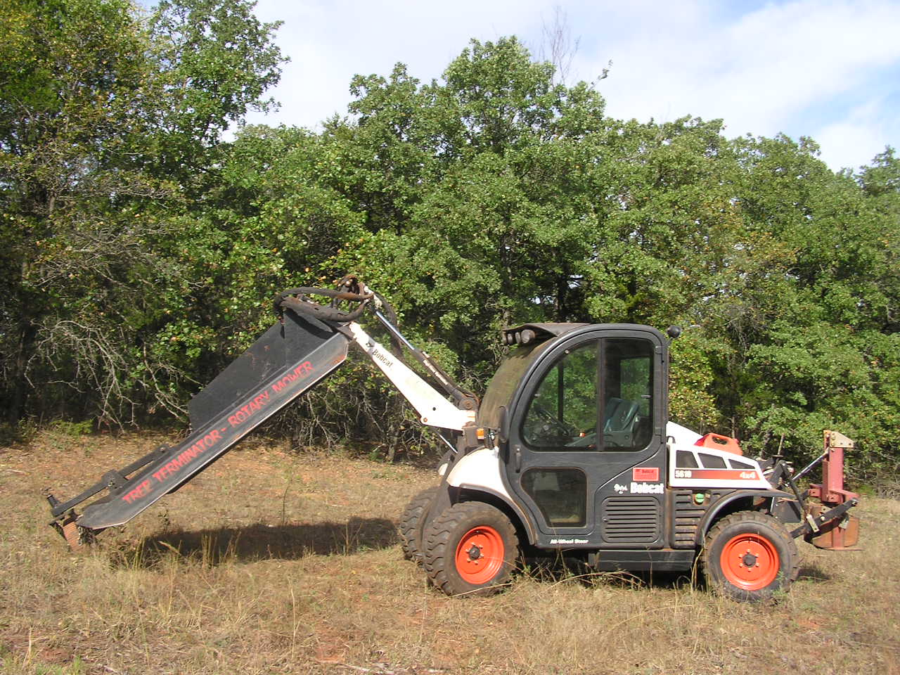

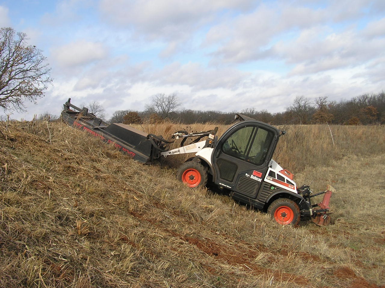

Do you ever worry about sharp "stumps" puncturing the tires? I often mow in reverse, because I'm not comfortable running over some of the larger stuff I cut first, and sometimes worry about the small stumps left, but so far no problem.
These are impressive setups for sure! Best part is, you can bring someone along for the ride!
What is the lift capacity on the 5610? How about the pressure and flow with the high flow hydraulics?
   / 5610 cutting brush.
#32
The "stumps" are splintered and not sharp and no problem for the 8 ply tires.
Lift capacity is listed as 1500 pounds, but it handles the 1800 pound mower just fine. I measured just over 3000 pounds of lift with nothing on the SSQA.
Aux pressure is 3000 and flow is 28 gpm.
With 4 wheel steering it gets around the big trees very nicely.

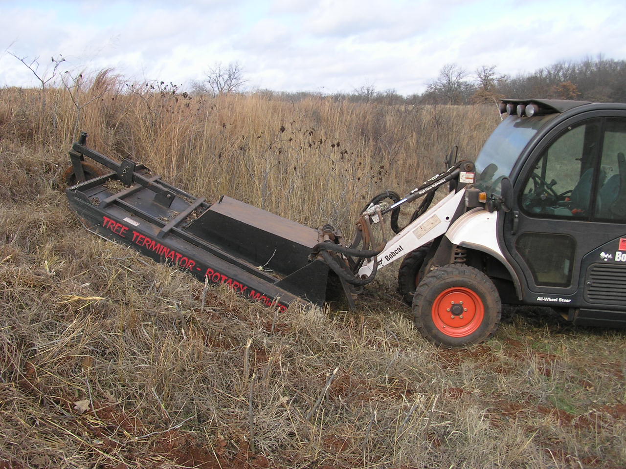

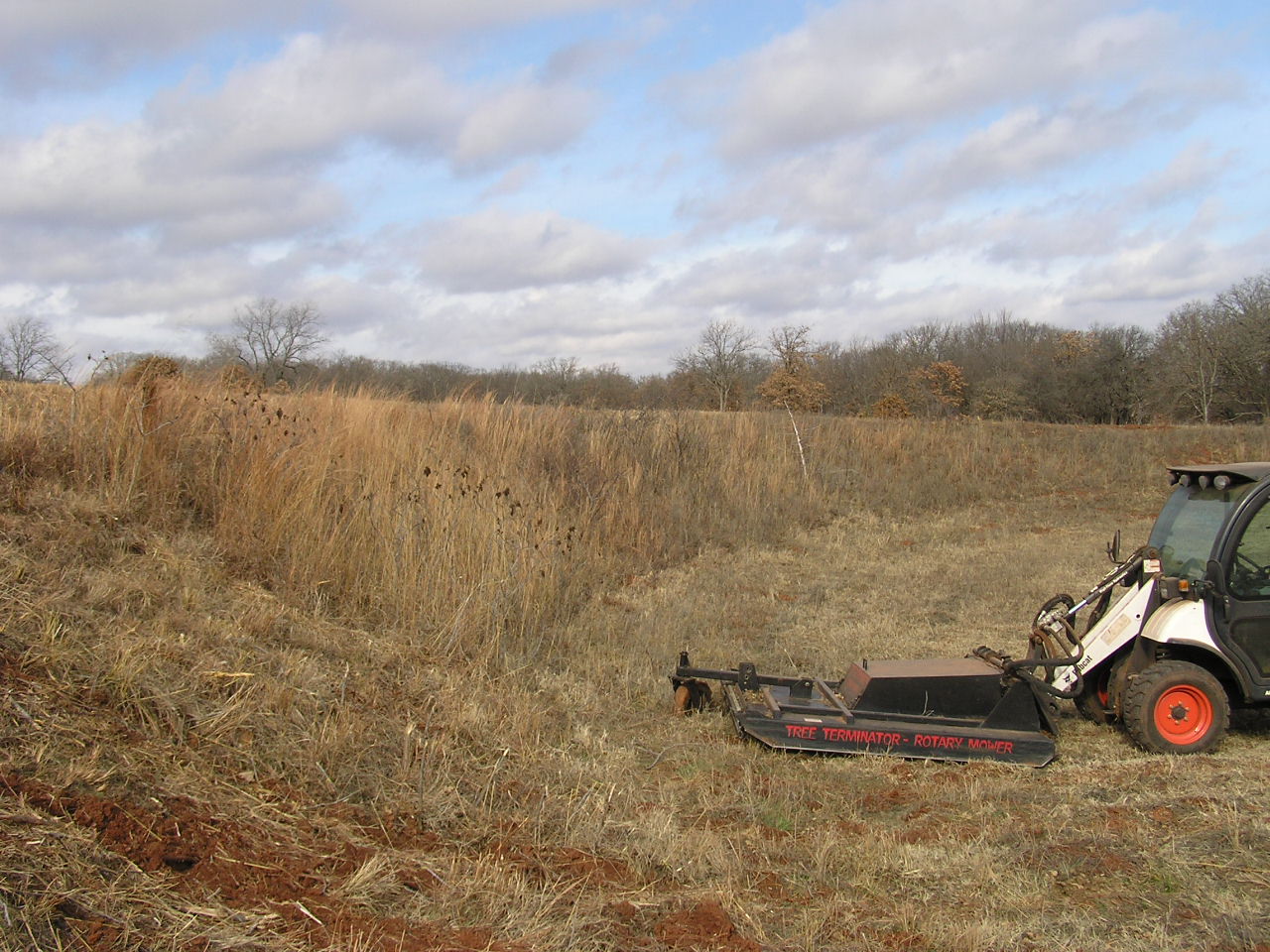

3 and 4 inch cut quickly with very little effort. 6 inch trees you have to go slow and let the blades beat on it a bit. It works well because the front of the bushog has a bar that is raised about 18 inches that pushes the tree, so as the blades hit it, it pushes it over more and opens up the cut. Having said that 6 inch trees feel like they are rough on the machine and once they are down it beats the machine up trying to mulch it. Anything over 4 inches gets the chainsaw. 4 and under get the brushmonster.

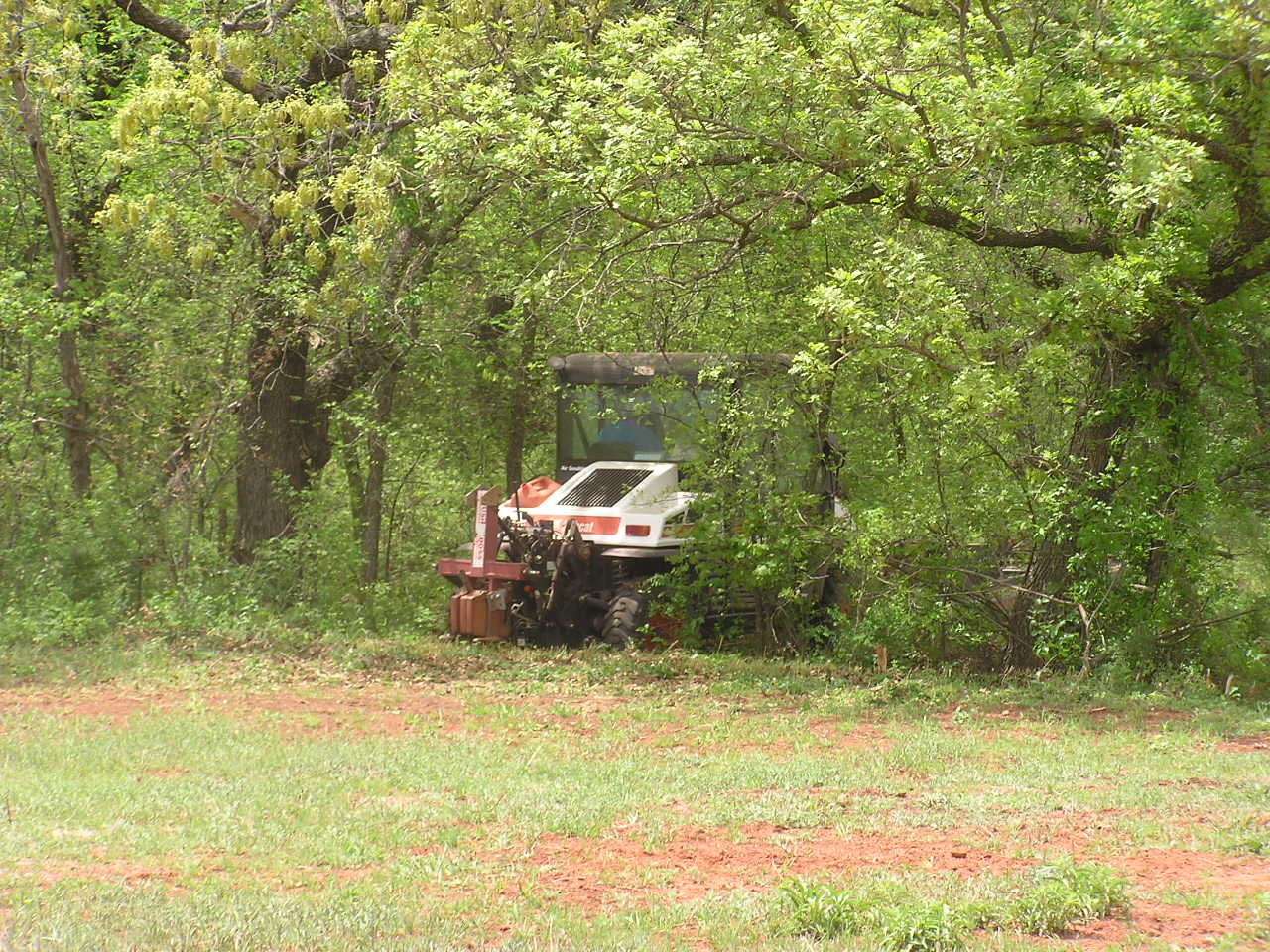

Found some old pictures of cutting brush in the spillway:
