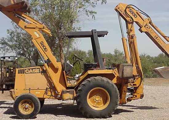

I found this nice backhoe on the www.traderonline.com site, and noticed it had a hydraulic thumb (rare to see on a backhoe). I was wondering if any of you know how much of a hassle it might be to put these on a backhoe? My boss said it's not worth it because you have to have a seperate function for the thumb so you can move it and other parts of the hoe at the same time. He says it's just too much work for a backhoe. I'm asking because it would be nice to have one on an extendahoe but if it's not worth it, then I would just put a mechanical thumb on. Hydraulic thumbs are nicer because you can obviously position the bucket whichever way you need to get at something. Just curious.

I've seen some information on an electric valve for duo purpose hydraulic purposes.
Let's say you want to have the hydraulic thumb. You don't want to add another lever. So you put the electric valve where one way it operates, say your left stiff leg. Once you're in position and start working the hoe you change the valve over so that lever now works the thumb. You flip the button when you want to move the hoe or readjust the stiffleg.
I can find a link to where I saw the thing. It was a manufacturer of a hoe attachment for a skid steer. They had the hydraulic movement of the bucket and the electric valve also allowed the boom to operate right or left using the same auxillary hydraulics.

Our 580M at work has two additional hyd. circuits out to the end of the hoe. One is for the wrist (which is always attached) and the second is aux, which we hook up to a grapple instead of a permanent thumb. The hoe controls are the two-lever setup, so the two additional circuits are controlled on the floor with the left foot, while the extendahoe is on the right. Makes for a slick setup with plenty of power all the time.

Yeah, well, I don't like the looks of that thumb. I think companies can do a way better job in attaching those guys on a backhoe and not have the stupid cylinder sticking out. If that was my backhoe, I'd take that off (obviously if I baught it because if it were mine in the first place, I wouldn't have put it on), once I had money, I'd buy another 580D and this time an e-hoe, and switch hoes, and then if I had to, put the thumb back on. A thumb on an e-hoe is way more useful in my opinion. But, if I were just starting a business, I'd be a lot smarter and not get a standard hoe first, but an e-hoe. Much more useful, then I'd get a standard hoe. Kind of nice to have in muddy conditions so you aren't sinking everytime due to large amounts of tonage from the e-hoe. Just my thoughts. Oh, I think it would be cool to have a lever right above the feet, so you can control the thumb there. Right side opens, and left side closed the thumb. That is if your case in the standard 3 lever 2 pedal hoe. Sorry to have posted this in the wrong forum, I just thought of that, should have gone in the 'attachments' one.

Hi Blake I had to build a Thumb for a customer at my shop he owns a 97 model 580 with the standard boom and stick, Since its Ductile iron and a cant weld it i built a clamp on system. I have a thumb on my 75 Ford hoe its a stiff leg because i have to remove the extra 100 pounds when im loading my dump truck with the hoe from terraces. One thing to consider with a hydraulic thumb is to get a pin for the bucket thats widenough to go through the thumb and bucket . This lets the thumb stay in the same radius of the bucket. Now im building a V ditching bucket.
