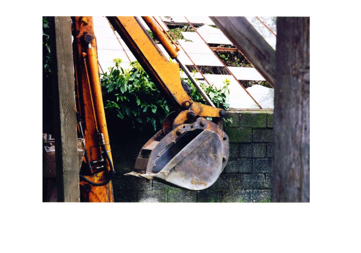

Hi Blake I had to build a Thumb for a customer at my shop he owns a 97 model 580 with the standard boom and stick, Since its Ductile iron and a cant weld it i built a clamp on system. I have a thumb on my 75 Ford hoe its a stiff leg because i have to remove the extra 100 pounds when im loading my dump truck with the hoe from terraces. One thing to consider with a hydraulic thumb is to get a pin for the bucket thats widenough to go through the thumb and bucket . This lets the thumb stay in the same radius of the bucket. Now im building a V ditching bucket.
/ 580D case with thumb
#11
Oh, that makes sense. Something similar to this. This is my boss's backhoe. It's not hydrauli obviously.....Thanks for the tip.
