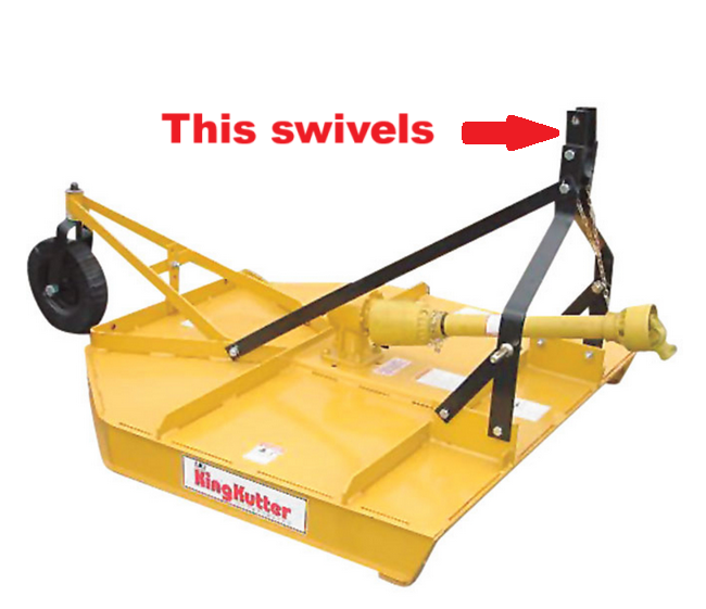

I’m new. What is a chain or rocker link assembly and how does it work?
I have also suggested a chain in place of a top link. Add some type of ring on each end of the length of chain large enough your top link pins will go through them. This should allow slack when cutter is lowered, but tighten to lift cutter.
A rocker is a swing mount on the top of the 3PH of the cutter that allows for some forward and rearward swing of the top link. In my opinion the work well for mostly level yards and pastures, not so much in hills and rougher terrain.
