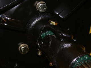

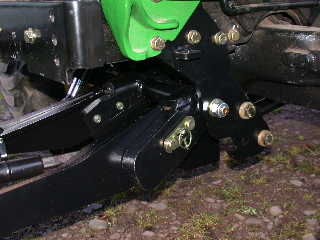

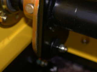

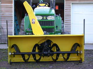

Here ae some pics.
You can see the front hitch comes right off. The two plates at each end of the blower are for the shear pins.
If you look at the photo where the 3ph attaches to the tractor you can see how they have it set up to come off easily.
The picture of the impeller shows a grade 5 bolt which I suspect should shear if the impeller jambs, let's hope so!
Rob

   / 59" blower for 3x20 series #17
The parts are beefy, and I'm not much concerned about destroying them, but I don't like the idea of digging the front hitch into the ground and getting dirt in the bearings or all over the PTO shafts. I'm far less worried about the driveshaft itself. On my 4200 it gets out of the way pretty quick after leaving the front hitch.
I've never broken a shear pin. But I don't think they're even half the strength of Grade 2.
EDIT: you posted as I was replying.... I can't believe you have grade 5 bolts for shear pins. Grade 5 can take a lot of shear force without breaking.

Deere's standard shear pin IS a grade 5.
