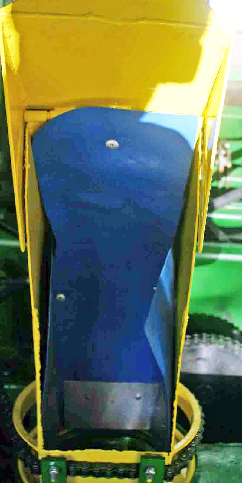

I decreased the amount of plugging by lining the chute with the plastic from a "flying carpet" sled
