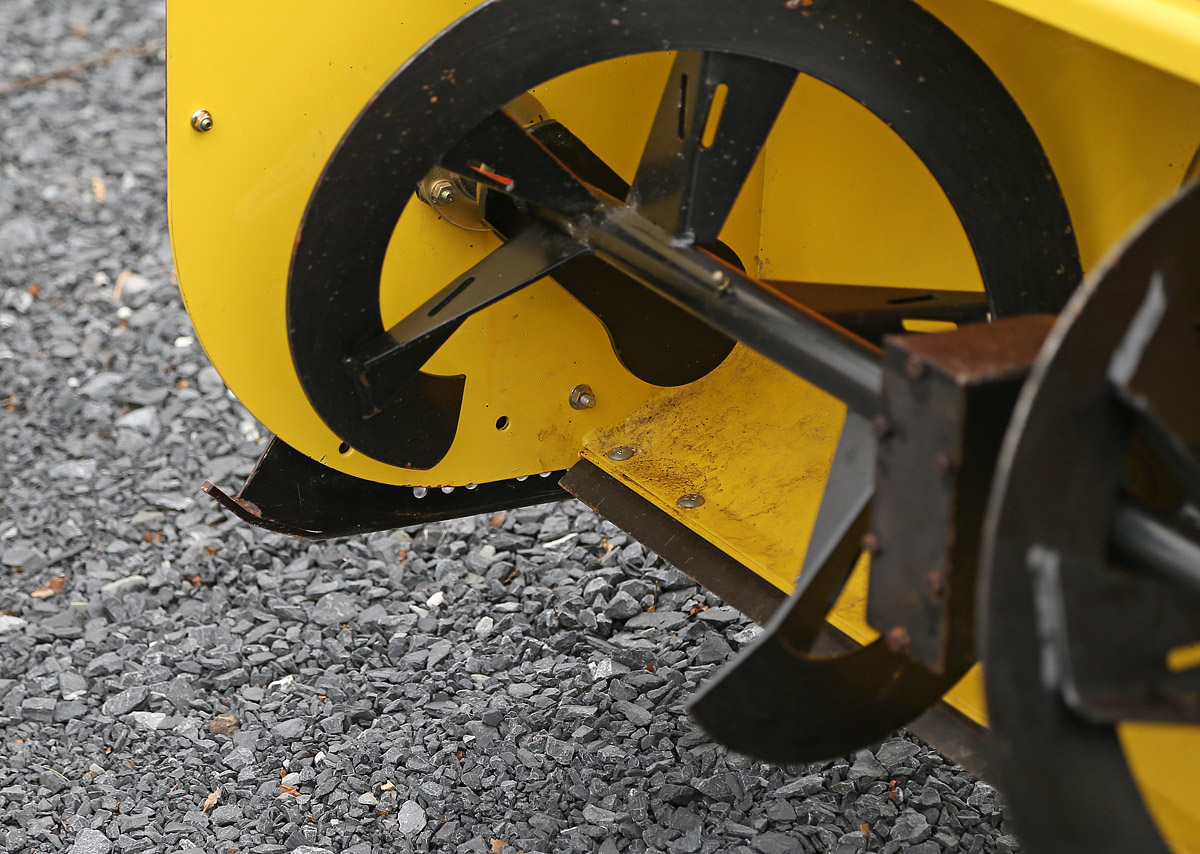

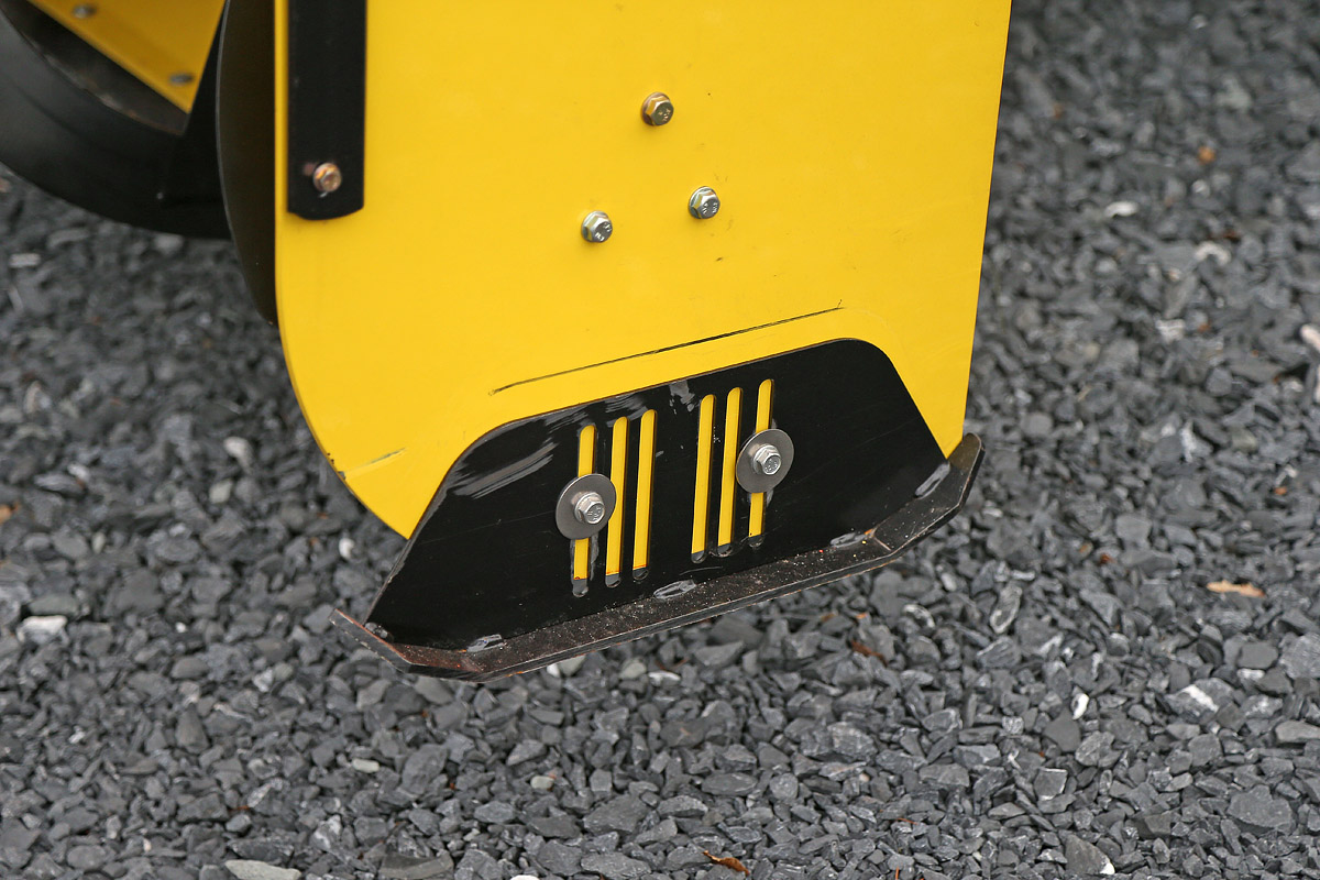

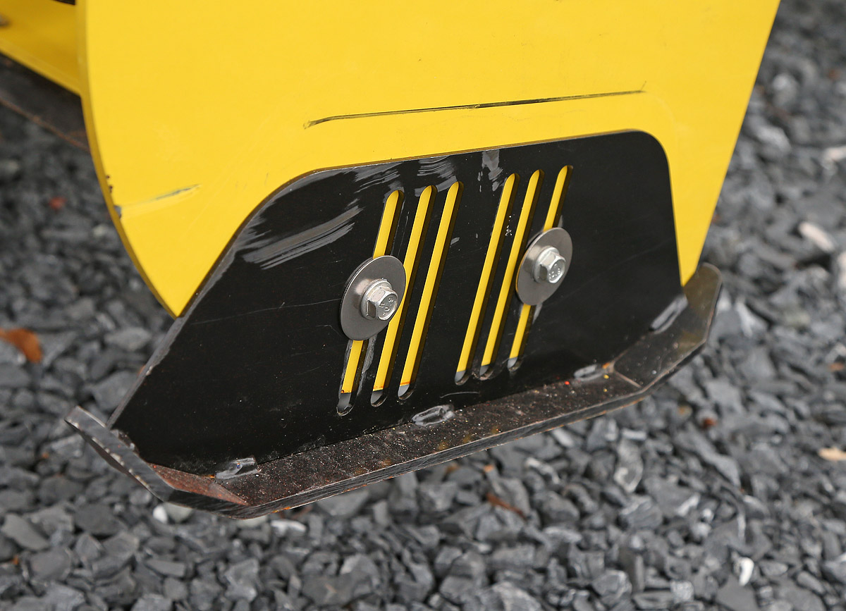

They make them to fit the 59". I originally found out about these from an article by a guy who bought them for his JD 59" blower. He posted photos but I cannot find the article at the moment. Don't worry too much about their "fit" chart. It is not very complete. Simply measure your bolt spacing and order accordingly. That's what I did for my 54" and they work perfectly. The photos below are of my JD 54" blower.
I clear some paved and gravel driveways in the neighborhood. The scribe mark helps me quickly adjust the height for each. I also added large stainless steel fender washers which help to hold the shoes adjustment.

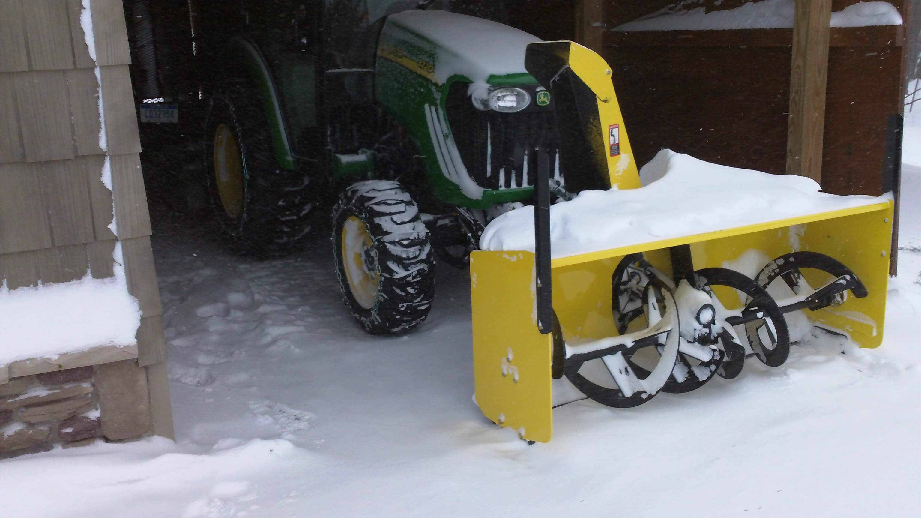

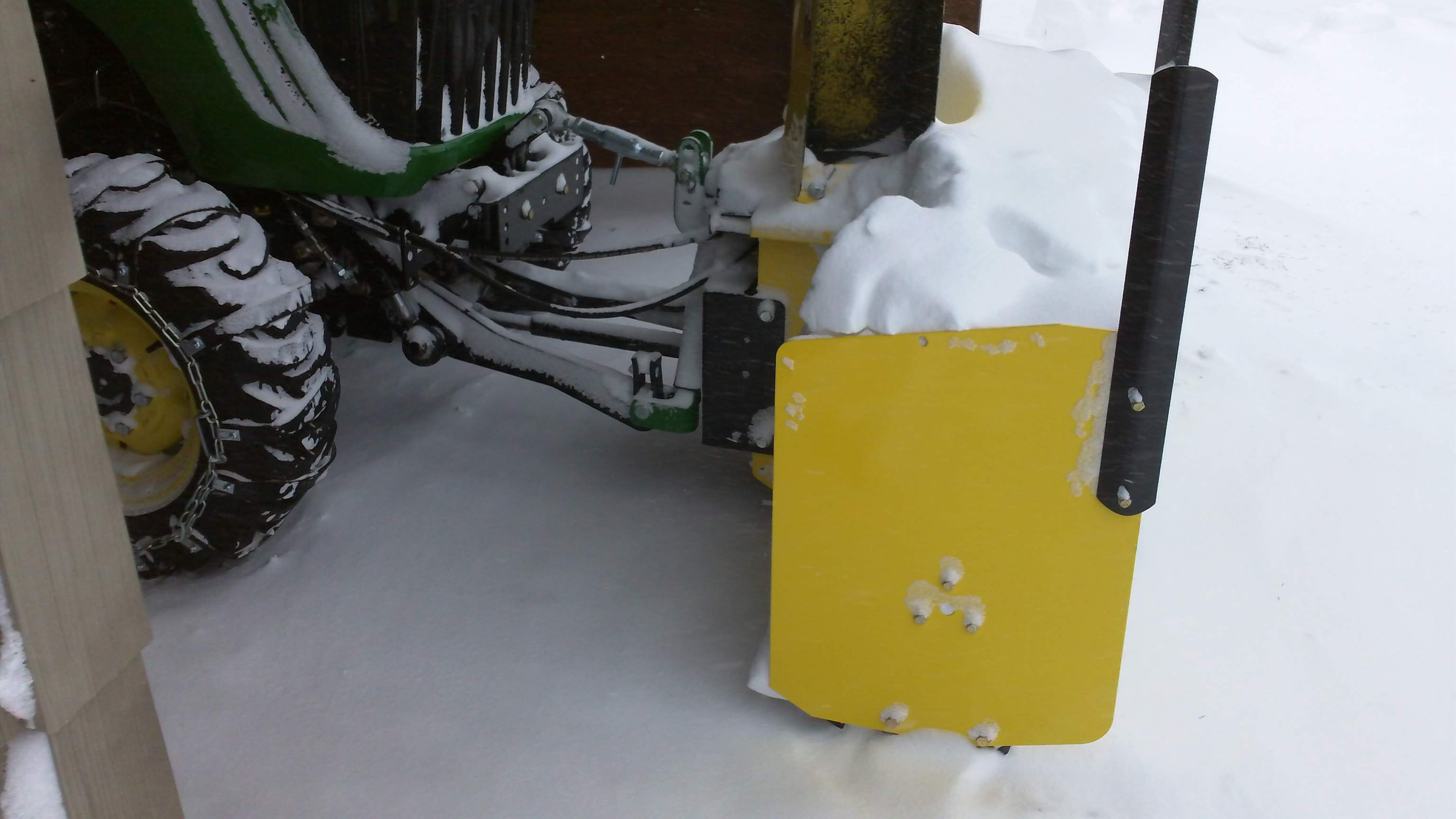

Thanks, I'll check into those shoes. Here are some snowy pics of my rig that several people requested. I can raise it up a bit and manage, but it's not as good as I would like. Probably have to wait till summer at this point to do anything, but want to do something to improve it. Although the shoes would be easy enough to put on in the winter.

Doesn't look like a hard-to-fix problem by having some larger shoes. Doubt they would compromise the task of blowing away snow on a gravel drive.
Curious about what you have for chains shown on the tires. Look like they would be chains for paved drive, and not so great for gravel. Just wondering..

beenthere, those are rubber chains from rubberchains.com. I used to park the tractor in the garage and didn't want to trash the floor with regular chains.
They work reasonably well, not as good as regular chains, but better than no chains. With the 4x4 I could probably get by without chains but a little assist is nice.

Have to agree with the rubber tire chains. I had them on the rear tires of my previous John Deere X485 with snow blower and they worked great. Used it for 6 years and the rubber chains showed practically no wear at all when I traded for the 3720 cab tractor with 59 blower like yours but without any chains. My 3720 doesn't really need chains with 4 wheel drive and liquid ballast in the rear tires.
