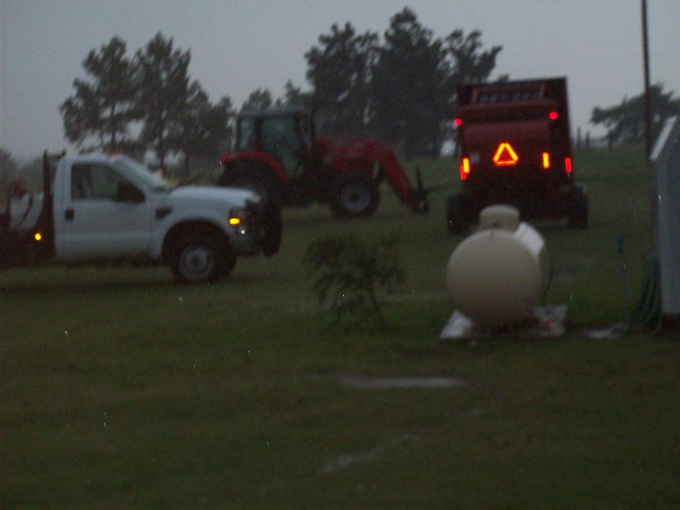

Well Friday turned out like this 1.5 inches.
Finally started cutting again this morning. I might get something done if I could keep a tractor under me. Mowed about 2 hours and stopped between feilds. Diesel fuel was coating the side of the block.:mad: The dealerships head mechanic will be out first thing in the morning. He thinks it is a return line leaking, I guess we will see. I have a hay customer that wants me to move a couple of miles down the road and do a 20 acre field for him in addition to the hay he is buying. I'm still not sure I have a tractor I'm willing to trust out on a custom job and I've got big ones lined up for as soon as the weather settles down.:eek: Top it off with orders for more hay than I have been able to get cut in the last couple of weeks and things are going to start getting interesting.
