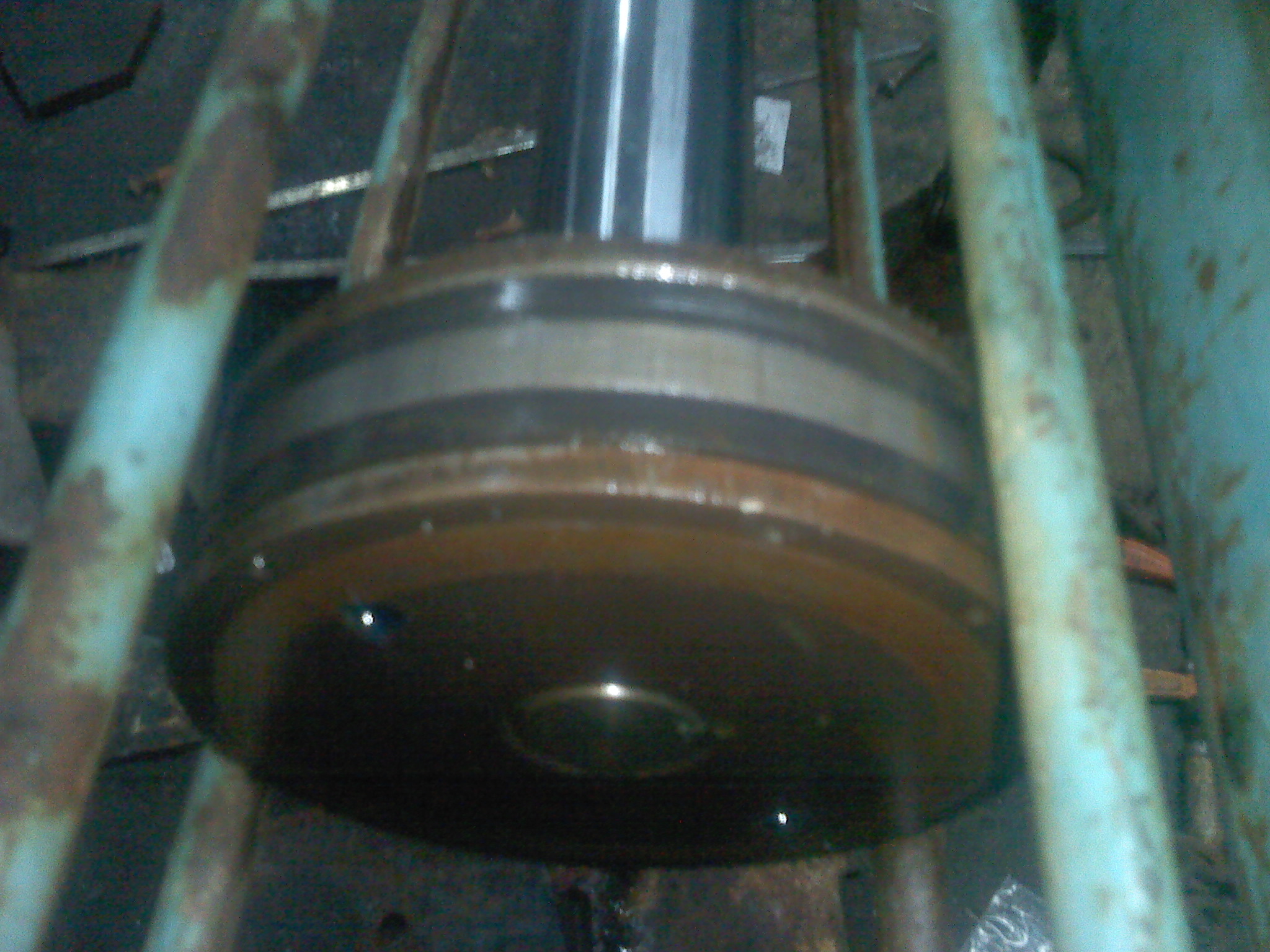

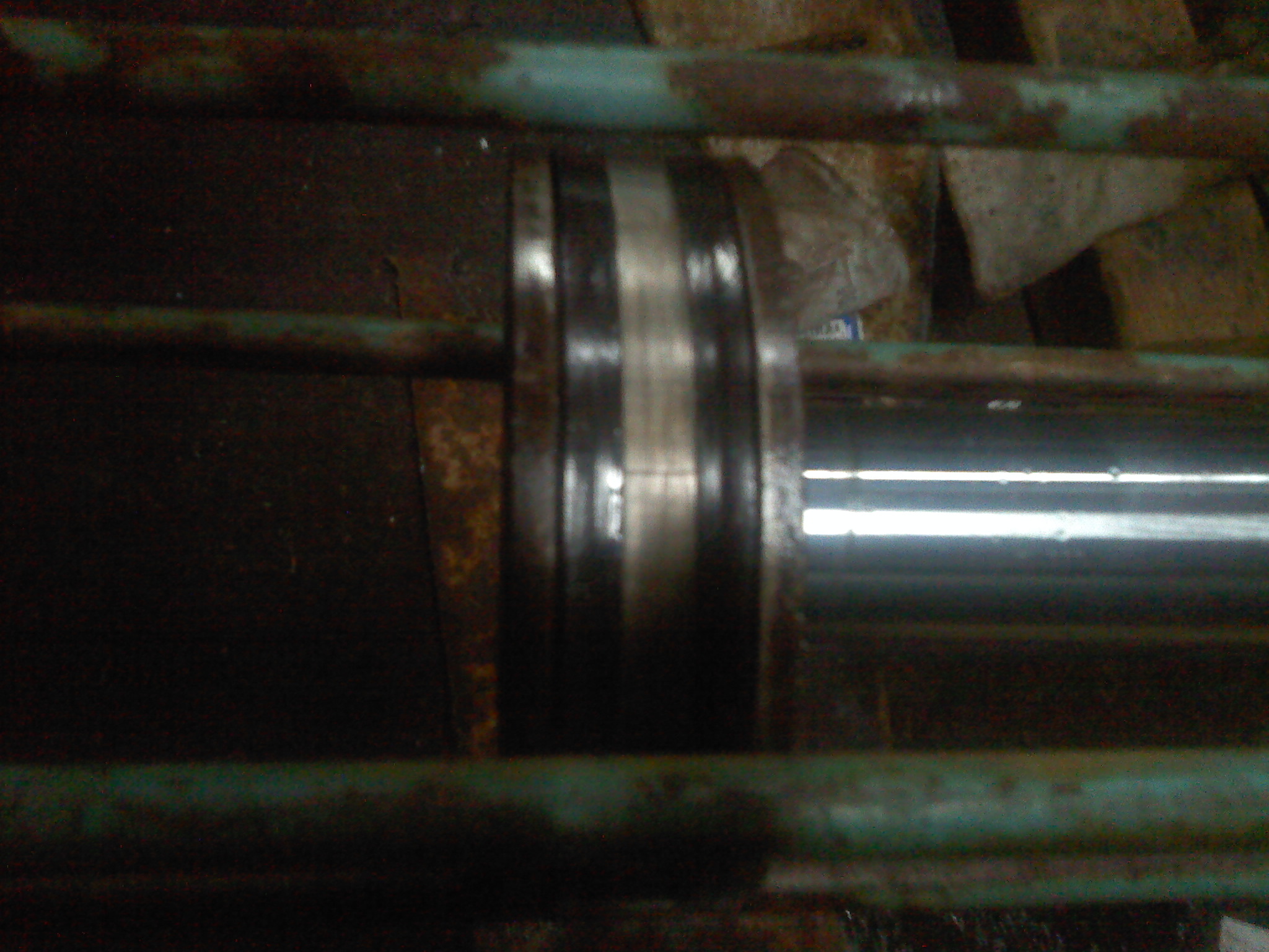

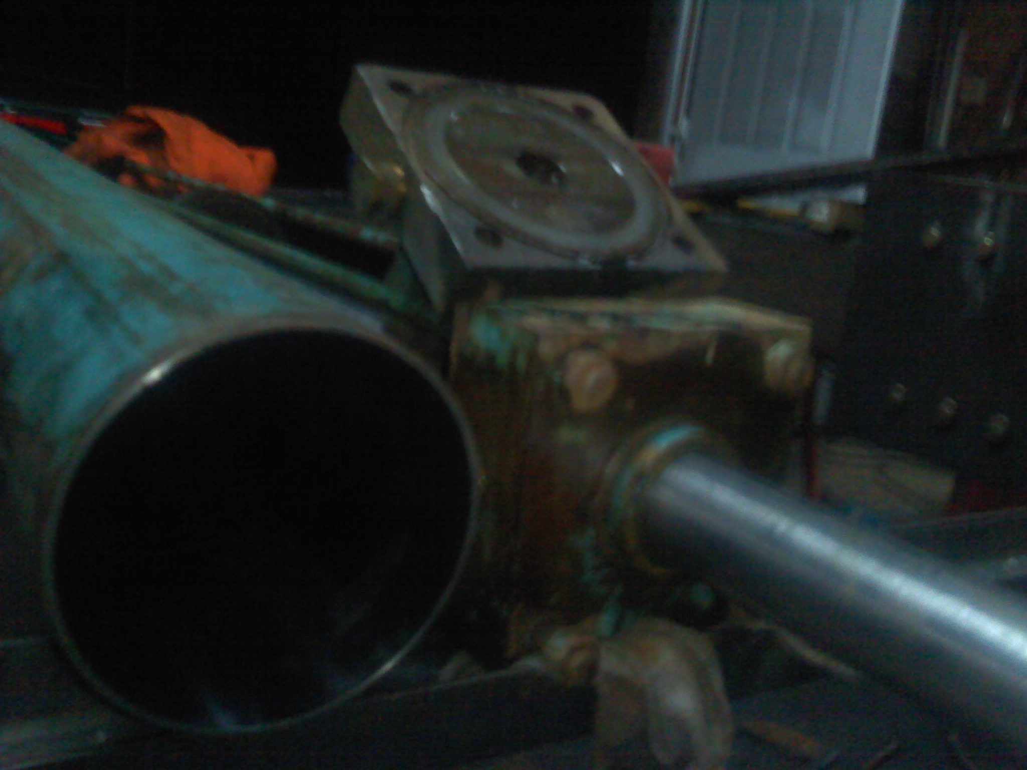

here are pics of the piston and endcaps and you might be able to see the barrel. I dont think its air, but its not high pressure hydraulics either

As a reference 2 1/4" steel tube with 1/8 wall is rated for 1400 PSI. So based on that I would also suspect it is 150 PSI Air cylinder.

I can only imagine what would happen if I hadnt of decided to ask before I proceeded to put this cylinder on my splitter. Looks like its back to the scrap yards tommorrow to look for another cylinder to use. I appreciate all the replys, each of you have helped to prevent me creating a potential hazardous situation. Thanks a ton!!

5" bore cylinder for 3k psi should have at least double that wall thickness. Chief uses 1/4" for a 5" bore 24" stroke tie rod cylinder. I'll bet those piston seals are very soft and not polyurethane. If that was a hydraulic cylinder those U-cup seals would poly.
