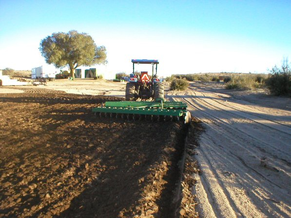

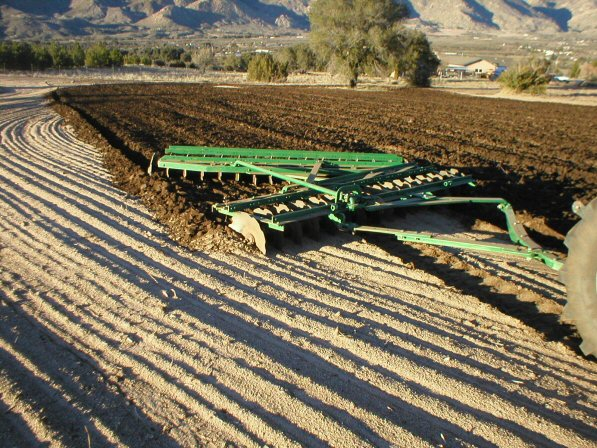

I know that I had to add around 3000lbs of ballast to get the maximum performance from my 75HP tractor.
I went from 7300lb bare tractor weight to about 10,500lbs.
