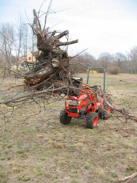

The advantage of a bigger tractor is mostly speed. I can knock down a coffee can size tree but I need to work at the roots a bit or give it several shoves while a bigger tractor could just knock it down directly. That said, I can still clear a lot of trees in a day with my 21 hp CUT. You have 16 acres which may be on the big side for 20hp range CUTs but is certainly doable especially if most of the land just needs an occasional bush hogging. I'm working to clear 5 acres and I'd buy my CK20 again for that task but I'd probably look at 30hp if I had a much bigger property and was intending to clear it all with the tractor rather than getting a bulldozer in (bulldozer still seems the best option to me as even bigger CUTs are going to be nowhere near as efficient as the dozer).
As many know, I am a grapple fanatic but it is mostly from having spent a year trying to clear land without a grapple. Consider that in your budget too. The combo of a grapple and bush hog on a 20-30hp machine would be more useful for the clearing you are anticipating than a 40-50hp tractor with just an FEL. For $20,000 you could get a slightly used 20-30 hp CUT, add a grapple, bush hog and BH and have a very efficient and flexible land clearing tool.
