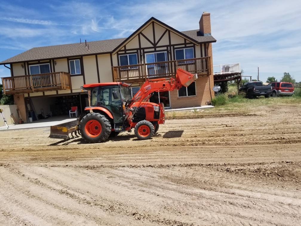

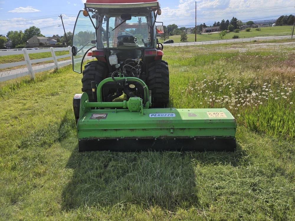

L4060hstc, 72" tire track. 74" heavy Gannon box blade. 60" land plane. 7 & a half foot heavy flail mower. The box blade is ok but a touch heavy, as is the mower. The LPGS will stop the tractor when it's full. I wish it were wider to cover my tracks, but I'm sure I couldn't pull it properly. I wish I had more HP for the flail. I wish the Gannon wasn't 30 years old & worn out, but not smaller.
