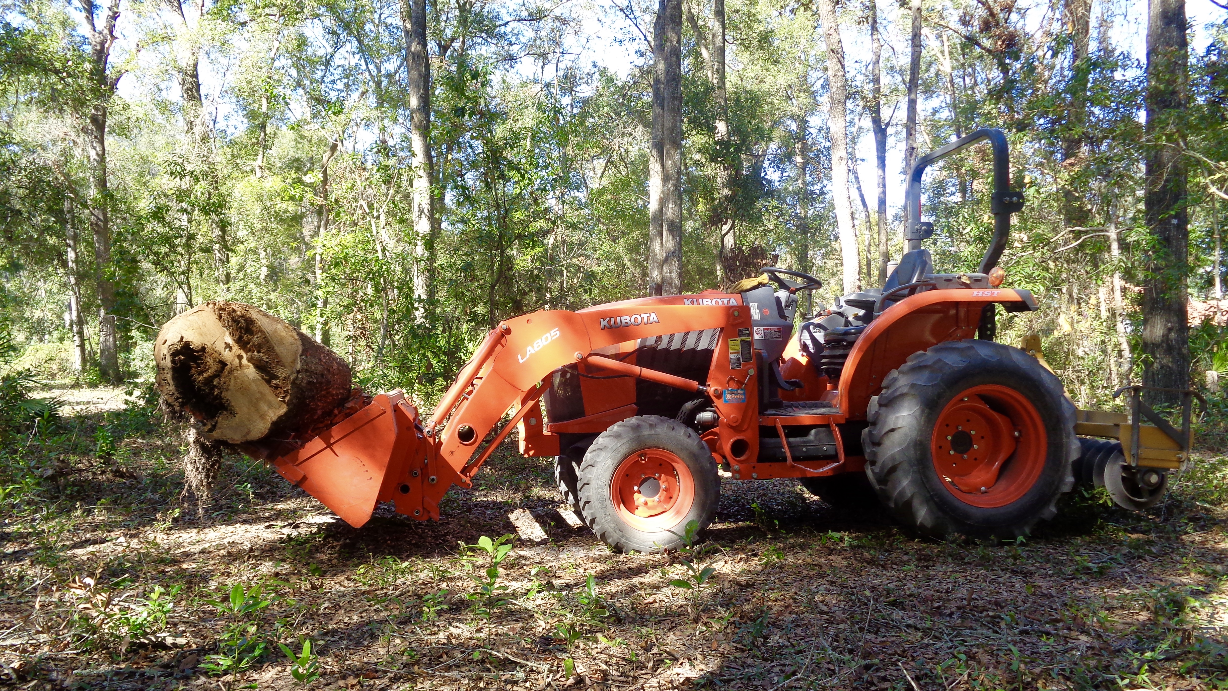

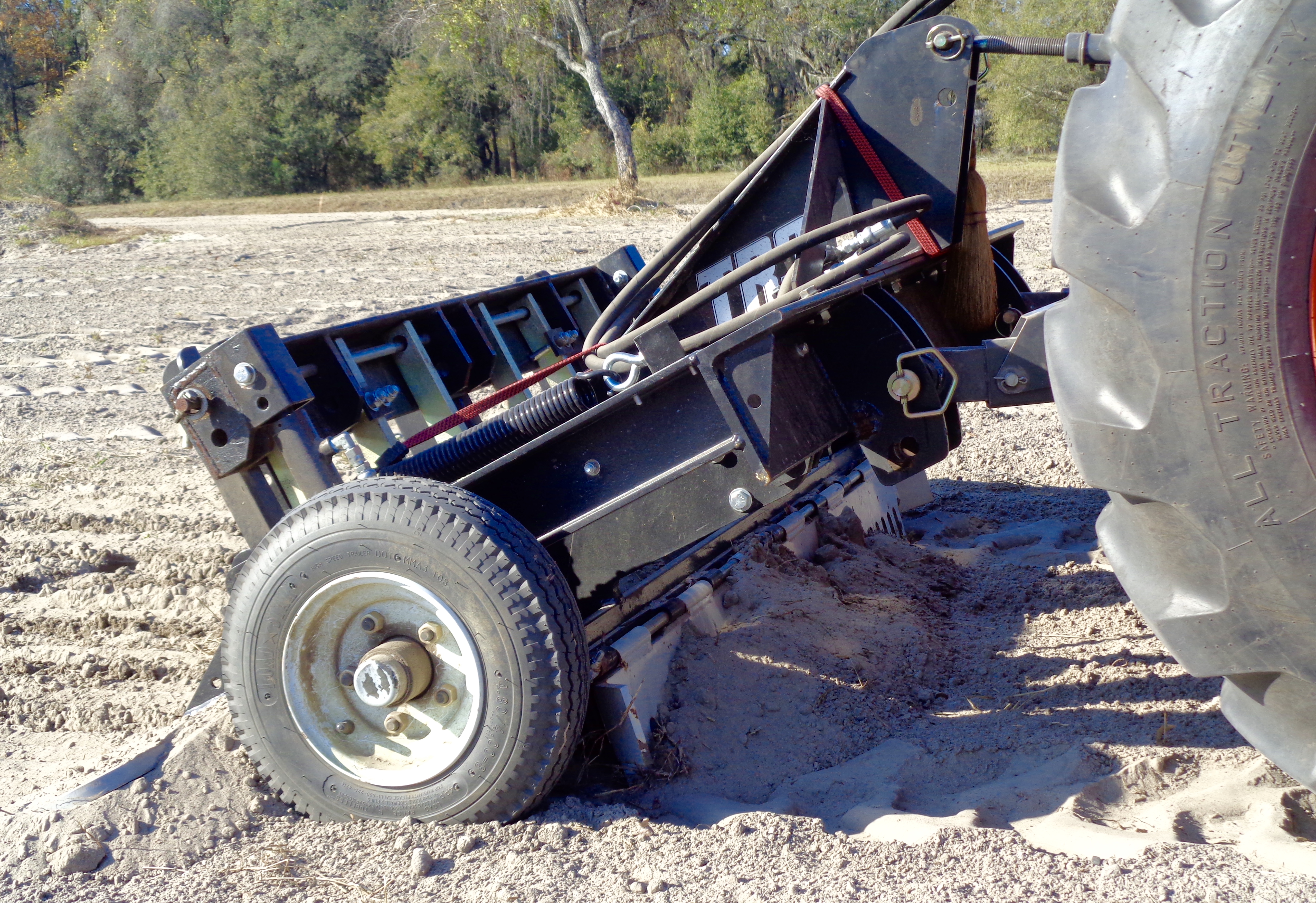

What are you using for Three Point Hitch mounted counterbalance when doing loader work? Counterbalance on the Three Point Hitch is cantilevered behind the rear axle and is far more effective, pound for pound, than liquid in the rear tires. Three Point Hitch counterbalance is normally around 60% to 70% of FEL lift capacity.
I have Kubota's LA 805 FEL = 1,700 lift capacity (+/-) Most of the time I carry an ETA 600 pound Cultipacker as Three Point Hitch ballast. Photo #1
If I expect to lift more I mount a 900 pound TR3 Rake, which is heavier than the Cultipacker AND PROJECTS FURTHER TO THE REAR. Photo #2
I use both the Cultipacker and TR3 Rake in trail maintenance, so alternate regularly.
In the interest of loader longevity I rarely lift more than 1,400 pounds but I can if necessary.
The weight distribution on a bare tractor is 40% F / 60% R. With a Loader, closer to 50% F / 50% rear.
RE: lawn; With loaded tires the weight is always there. You can detach Three Point Hitch counterbalance. My personal preference is for Three Point Hitch ballast. I would only load the rear tires if you work on hills reasonably often, when tire ballast lowers the center-of-gravity of the tractor.
You will not mark turf when soil is dry and you have 2-WD selected. When soil is damp, you may. You know how supportive your soil is better than anyone outside your area.
