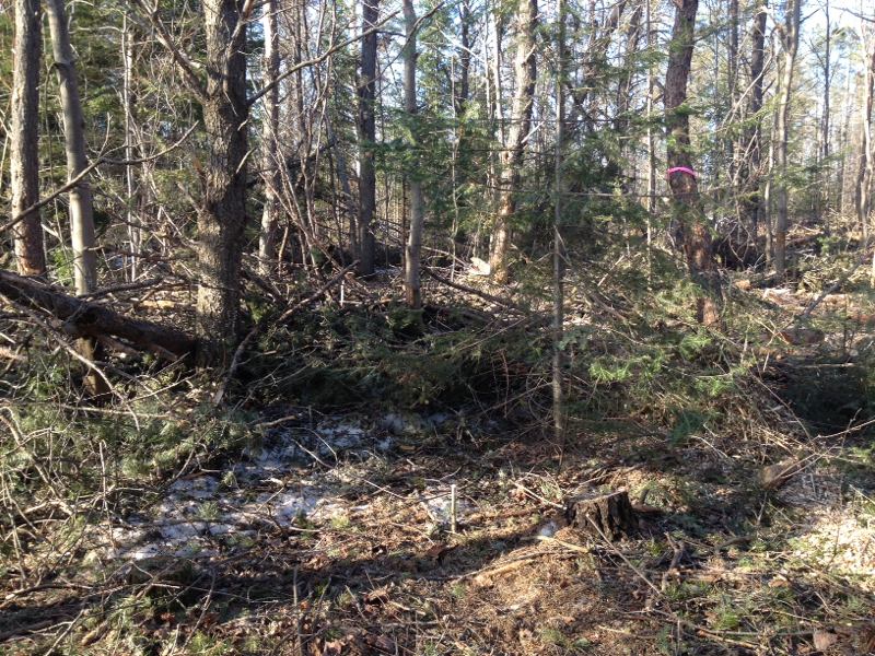

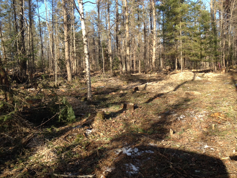

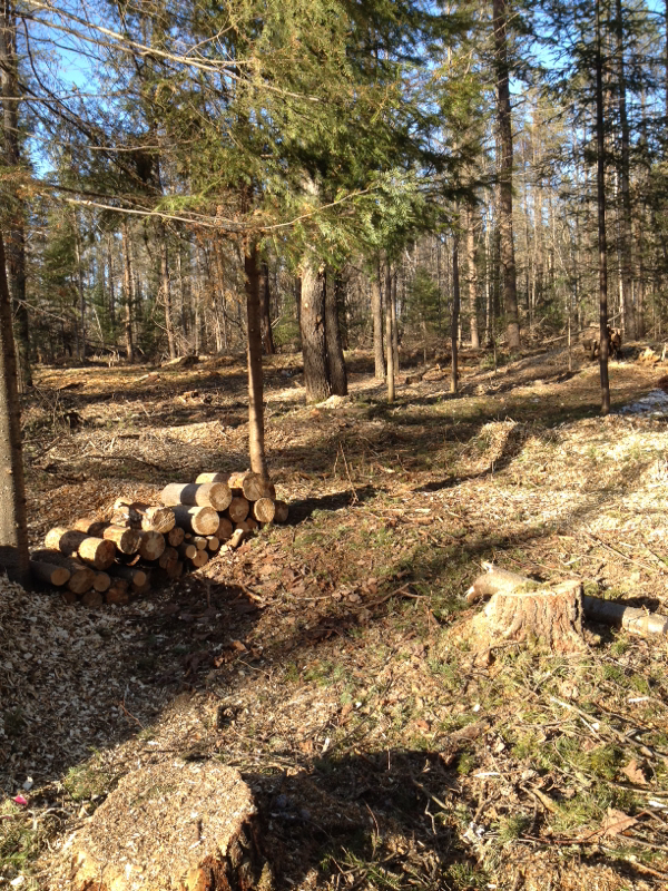

We're working on cleaning up 15 acres so far we did about one acre and it took us 50 hours and we were working hard!!
Before
After
We have a bx 42r on a L45 it's chipped everything we asked the only thing is the labour it takes to cut and put it in the chipper and I strongly suggest that you get a forestry saw much faster and easier on the back!
