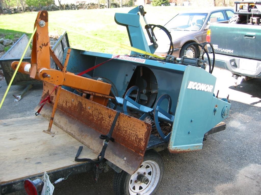

#13
Hey - the blower and blade made it home (almost squished my lil' trailer). The blade is a little rough, but the blower doesn't look half bad. Barring any unforeseen mechanical issues, I should be the envy of the neighborhood :).
JayC
PS - that's NOT me in the pic

   / 6' Snowblower opinion (Normand - Econor) #14
Blower looks to be in very good shape! The hydraulic options - if you were to price them out - would likely be around the cost of what you paid for the whole unit...! Bonus! The blade just needs a little paint and it will be fine.. :)
