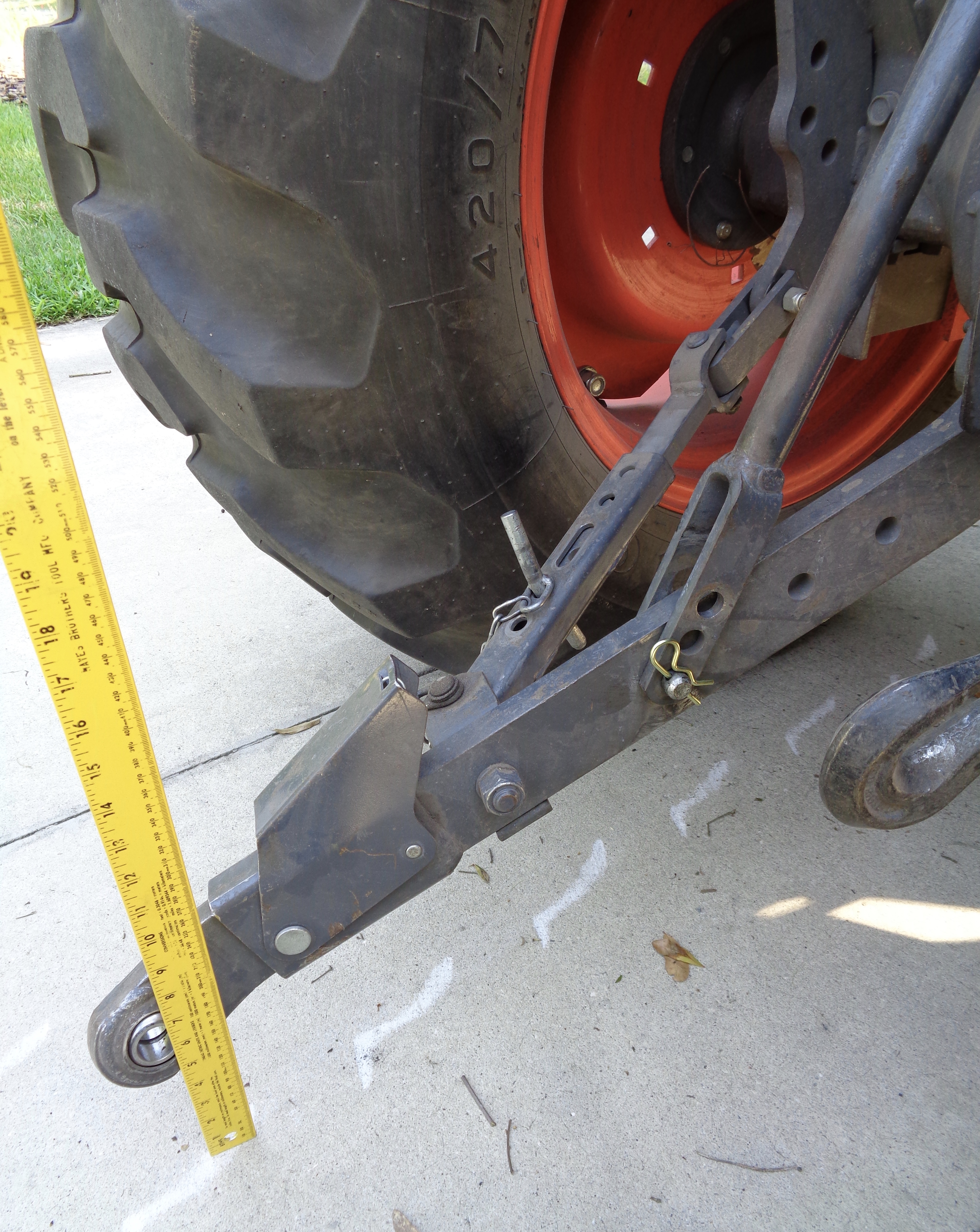

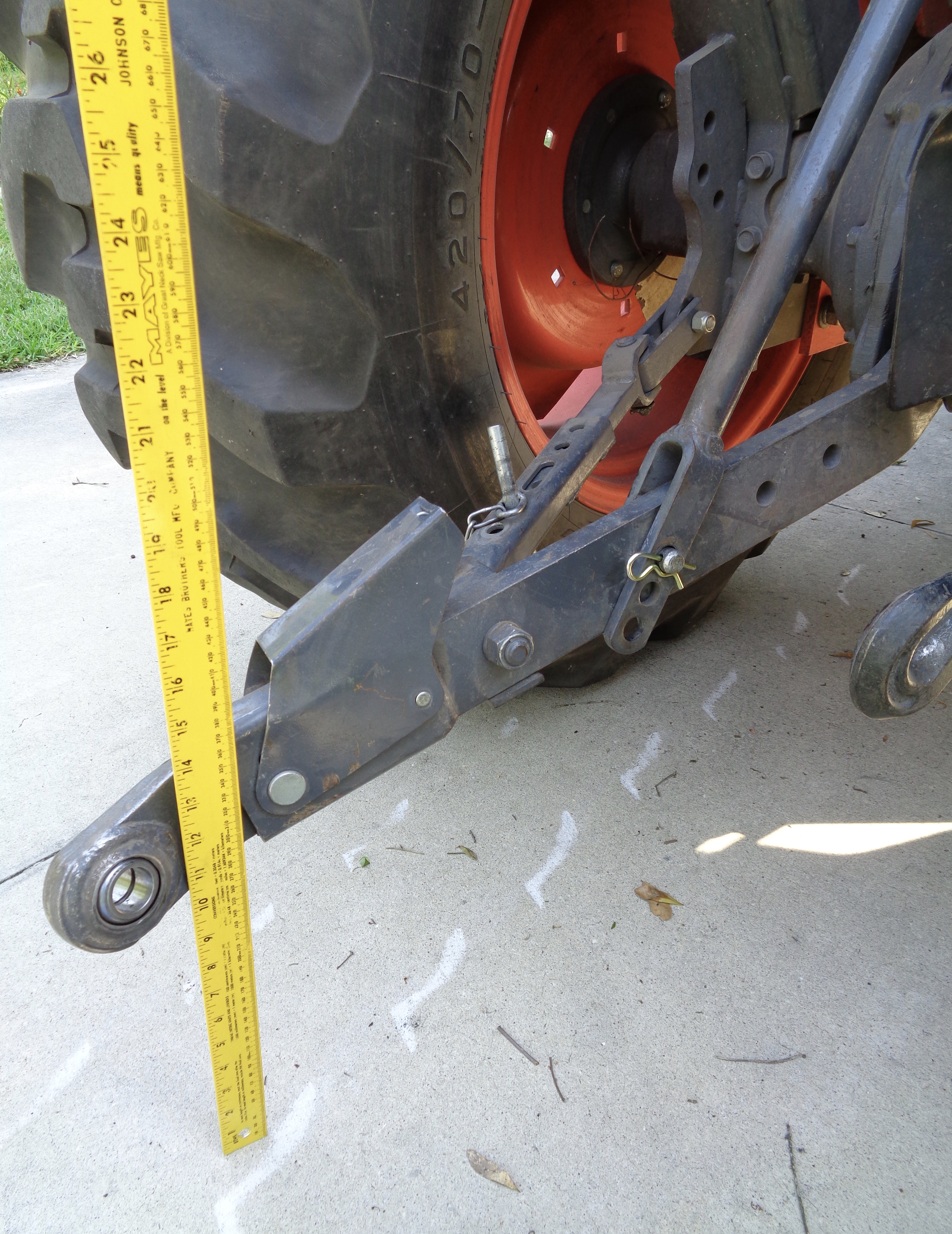

1)The tilt is not the same on both sides.
2) I want to be be able to tilt the box either left or right and have a control to self level to the tractor when activated. That was a feature on my Iseki Landhope 240 that I was referring to.
1) Hydraulically operated lifting rod is "normally" installed on the left side of the Three Point Hitch. The standard manually adjusting lifting rod "normally" remains installed on the right.
You may have to adjust right/manual side lifting rod to find an adjustment point that is not in conflict/opposition with the hydraulic adjustment on the left. You do not want either left or right threaded lifting rod extended too far or there will be too much stress on only a few threads, with the potential to strip rod threads to flatness.
2) You should be able to tilt the Box Blade by changing adjustment of the hydraulically operated (left) lifting rod. (above)
There is no Kubota kit available automatically level the Box Blade to the tractor. To change the peel depth of the Box Blade use the hydraulically operated Top Link. Also use the Top Link for adjusting Box Blade flat to prudently push dirt with tractor in reverse.

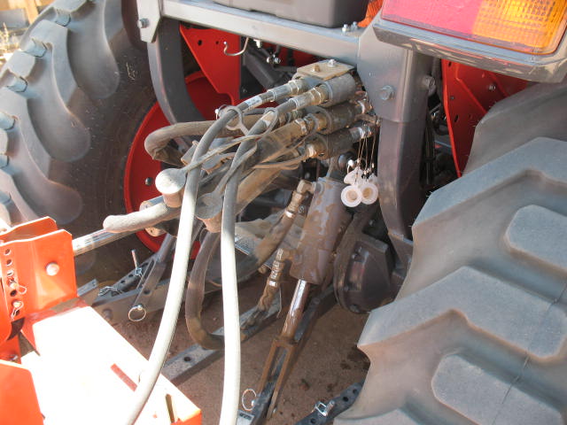

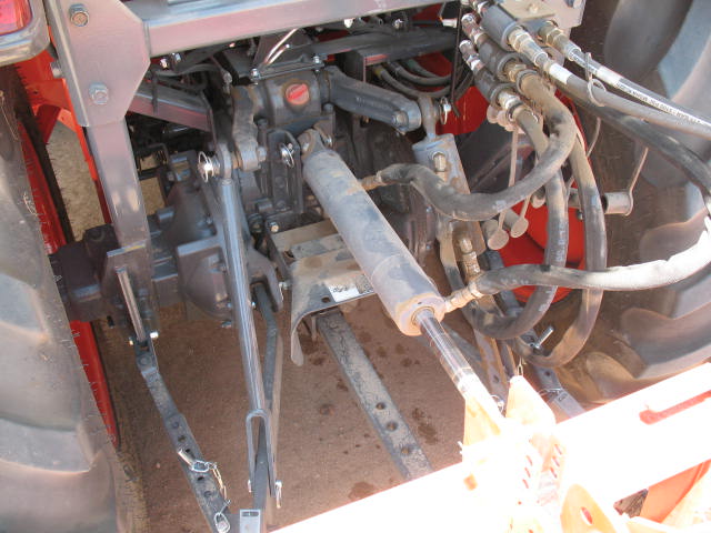

   / 6 way box
   / 6 way box
This is the Iseki

In your Iseki pic, the device piggy backed on the side of the tilt cylinder is probably what gave you the ability to self level? That's not a tractor specific device. I sure don't know what to call it. Might take some innovative Google searching.
I have the same setup as you do now. I use three rear remote circuits. I put my manual adjustable side link on the left side. Hydraulic on the right side like yours. By adjusting the length of the mechanical link I can change the amount of left tilt I can achieve. I keep it set where I can run the left side of the blade 2" below the right with the hydraulic link totally collapsed. This still leaves me with a lot of right tilt which is what I use the most.
Does your fixed left link have multiple holes in the bottom end so you could possibly get the same left tilt that I have by changing it's length?
   / 6 way box #11
Post #9.
I see your Kubota lifting rods are pinned in the lower holes which positions the Box Blade low. Not too unusual for Box Blades but the upper hole is the standard (default) adjustment.
You might experiment with pinning the lifting rods through the higher holes. If you decide to make the change it can only be accomplished with implement weight removed. Lube the short pins. As I use the lower pin holes occasionally with a toolbar cultivator and occasionally with my box blade, I use ring cotters in place of the factory straight cotter securing the short pins, to facilitate changes.
#1) The length of his fixed link needs changed so he can get left tilt.
YES.
You can "tilt" using lifting rod stirrup holes. Set right side in highest hole. Set left side in one of two lower holes. This method of tilt has advantage of not over stressing threaded lifting rod. Make fine adjustments with hydraulic control.

#1) I've never saw anyone install a hydraulic link on the left side unless they have two. The non adjustable link is on the left The hydraulic link is installed on the right to make it easier to view/control from the driver's seat. All levers are on the right side of the tractor so it's natural to look over your right shoulder.
#2) The length of his fixed link needs changed so he can get left tilt.
   / 6 way box #13
That was a common feature on some of these Japanese tractors. The device attached to the cylinder is just a linear encoder, so the electronics always know the position of the cylinder. This allow for a self leveling feature along with some crazy features that these tractors had back then. Features like 3 pt lifting automatically at the headland when Reverse is engage. I believe the 3pt was also electric over hydraulic like the big tractors had.
Most people don't really know how to use it properly because labels are all in Japanese.
   / 6 way box #14
From what I have seen, the manually adjustable right side link is moved to the left and the hydraulic link is put on the right.
