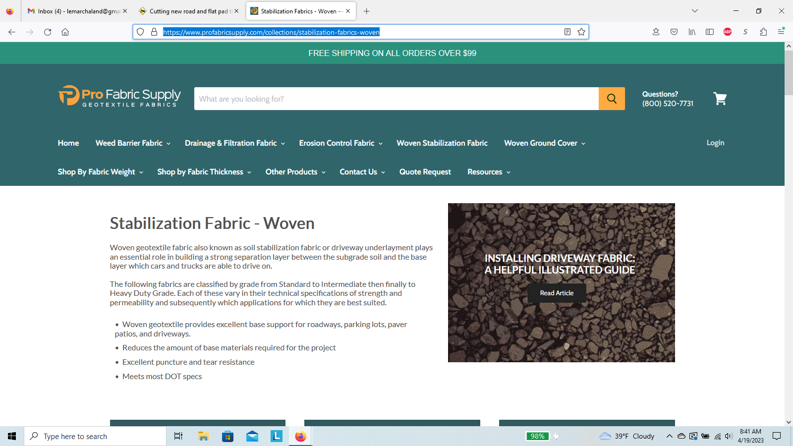

You can do it with your existing equipment. I would prefer a back blade with tilt and offset especially for cutting a ditch.
I would highly recommend a good highway fabric be laid down once you have your roadway and pad cut to shape and before any top dressing material is brought in, your gravel will say in place and not gradually subside into the sub base.
This place has a lot of information and materials;
Stabilization Fabrics - Woven
