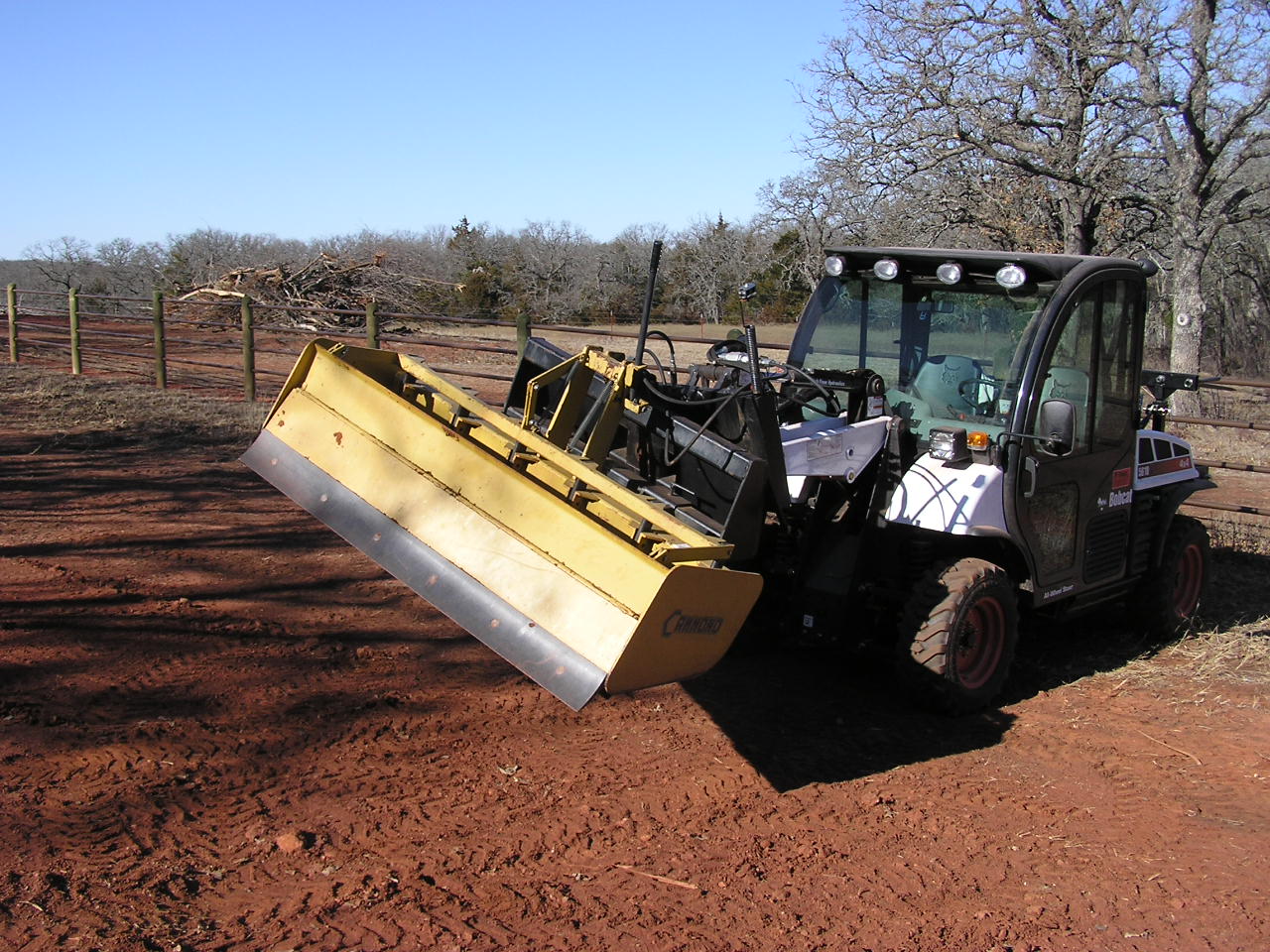

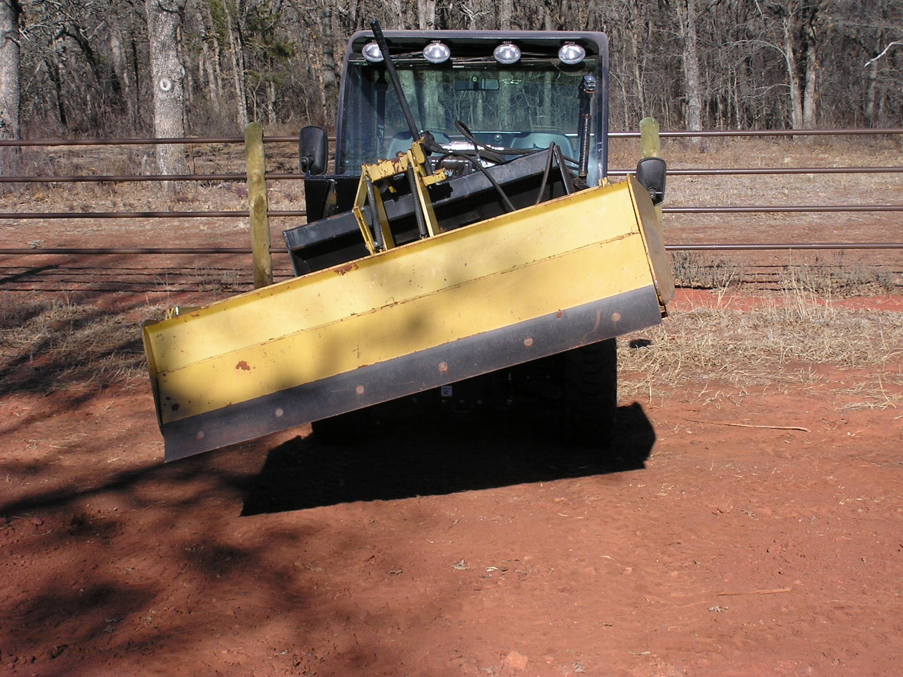

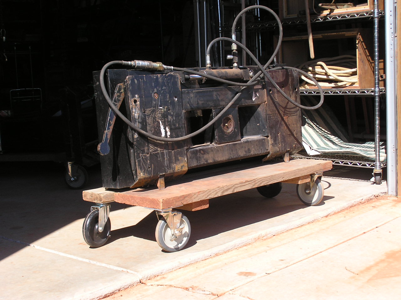

You have a T 650 I see, you know how it pushes without transferring the bucket weight to the machine when cutting or loading a bucker full. A dozer blade need's weight more than HP, the more the better. Your machine probably has as much HP or more than a small dozer that (depending on the size) might weigh half again or twice as much as your T650. Then there's the tracks but that's another part of the equation. I ended up with a "tilt attach" that go's between your loader and the bucket. It tilt's about 15* each direction from level. Much cheaper and IMHO more effective. See if you can rent or demo one. I think you'll be happy and have $4k left over in your pocket. :thumbsup:

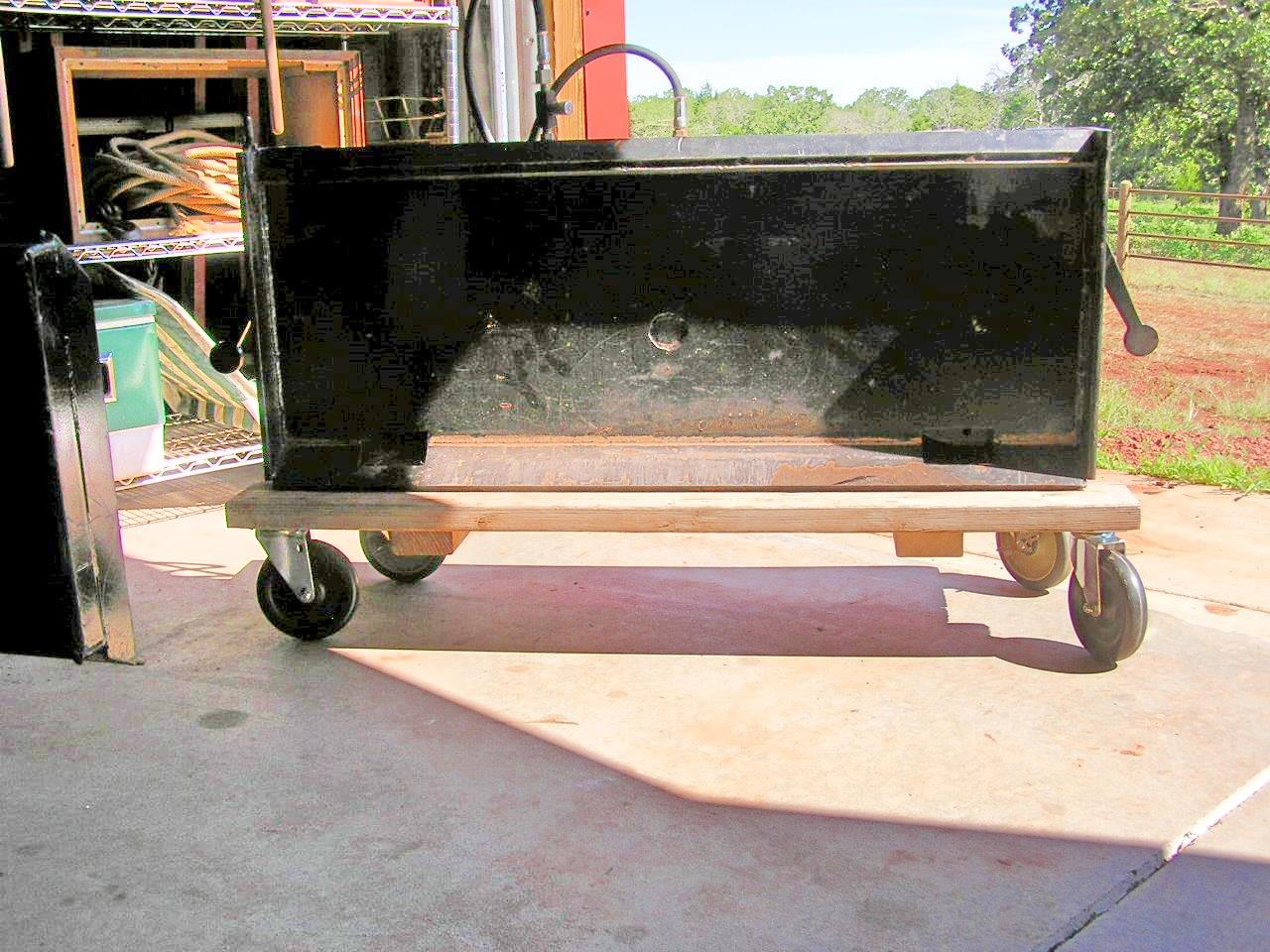

For those that haven't seen a tilt-tach:
With the 6' box blade on a 3 point adapter:
