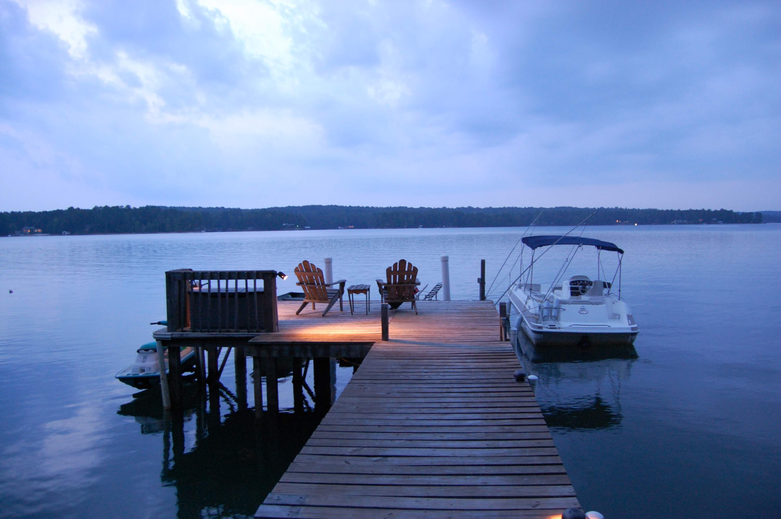

Here is an update with maybe a little better drawing:

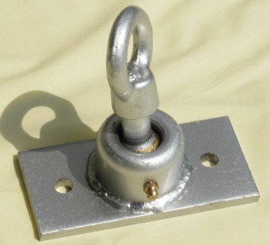

I have on order a swivel attachment for the rope. SPIKER, this may get the effect you were mentioning. Also, a picture of the pier. The 20ft 6x6 posts are placed right at the end of the narrow part of the pier. Hopefully the word document gives a better rendition of what I am trying to accomplish.

Where did you find that swivel?

Well I forged ahead with most of my original plan. It may not be all that pretty but I think it will be enjoyed by grandsons (6,3,2,4 months). Poppa will have to give it a try also.
Of course, the water has to come back up before any swinging. Each year our lake is drawn down 10 feet.
I tested the rope and there is almost no give when all my weight is on the rope. There is some give when simulating the type of swinging that will be done from the pier. The "swing around" does cause some rocking of the posts
/ 6 x 6 Pressure Treated Posts #15
I've been confused on what you were trying to do, so didn't say anything. Seeing the picture makes it all clear to me. Must have been the bald in me!!! LOL
That sure does look like a lot of fun!!!!!!
