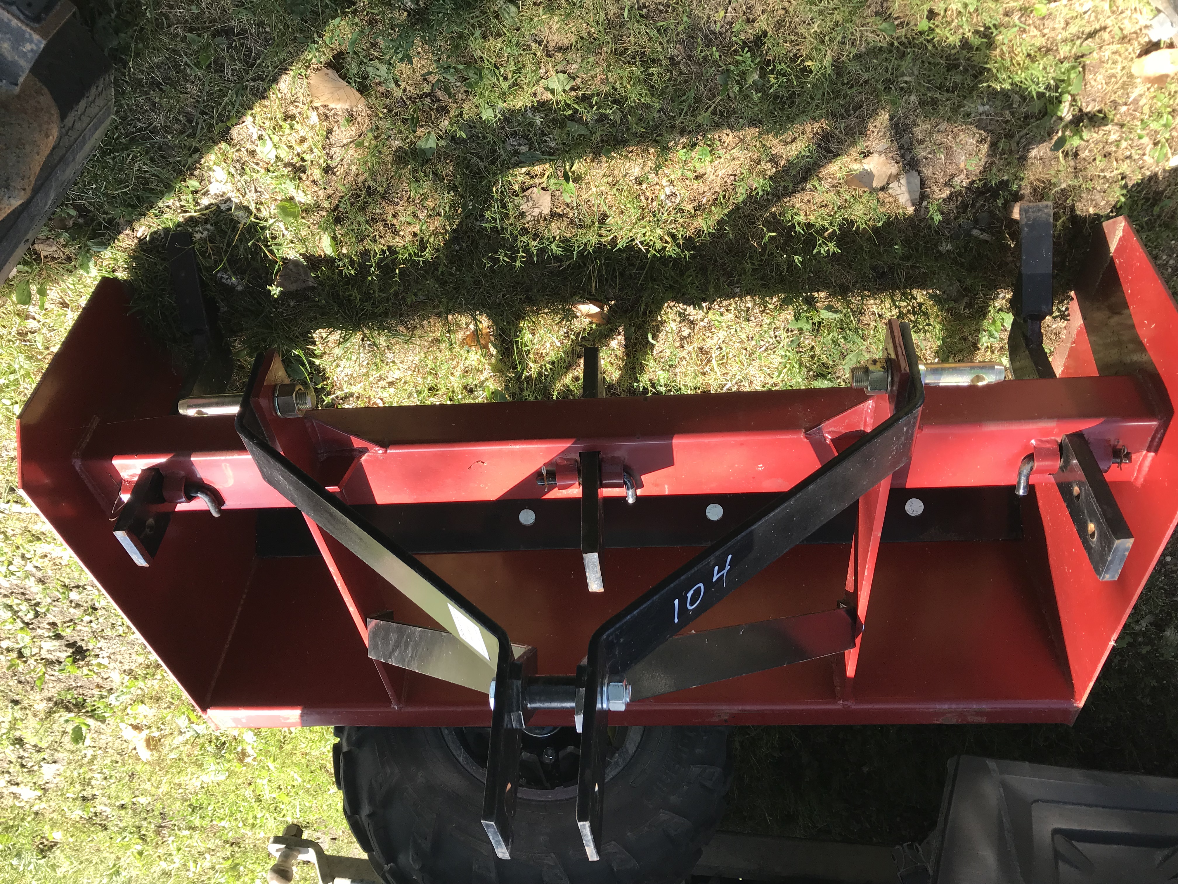

I realize this is a common topic here, but I appreciate the advice. I'm going with a 4ft Walco.
I like that Walco only uses three scarifier teeth rather then four on the 4 foot box blade, I think it will put less stress on the 22.5 hp tractor where a 4 tooth might be a bit harder, hopefully my new 1705 will be ready this week so I can start using it with the box blade as I have a bunch of stuff I want to do with it and then go over it all with the new back blade.
   / 60" Box Blade Recommendation (Canada) #12
One more thing and this only refers to doing driveways nothing else, as I see it when I do my driveway the middle tooth will rip right down the area that is compacted from the tires and with the 3 point adjusted right will leave a nice crown in the driveway where as a 4 tooth would rip on each side of the compacted tire track unless you were a bit to the left or right of the tire track and then you would need to work it a bit more on crowning the driveway.
The main use for the box blade will be for driveway upkeep being it is about 330 ft long. I still need to get pins for the teeth and adjust them, this is how it came.

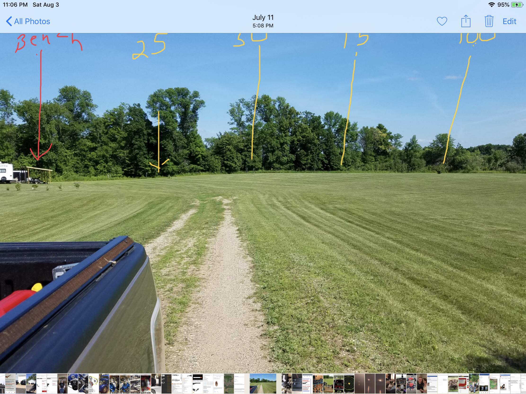

I will be doing a driveway that has never had anything done to it since the previous owner built it with a bulldozer 20+ years ago, this is the only pic I have at the moment( it’s taken 3 years to get it to look like a yard, they stopped haying it over 10 years ago ) but the driveway gets worse as you go down it the middle gets real green with weeds which i will get rid of and then I am going to have some class five dumped and I will see if he will just chain his tailgate open a few inches and drive down the driveway as he dumps, hopefully he is a good enough driver to do it smooth and even, I can finish with the back blade.

Imold. Single track driveways all look like that over time. If you don't like the look you can widen the drive so that you can drive all over it.

I like the clean look of a all gravel driveway plus it would be nicer to snow blow or run the bade up and down, the snow can pile up more on a single track driveway also. I will also mow the side of the ditches low in the fall so the grass doesn’t act like a snow fence, I have seen a clump of grass 5-7 inches tall on a driveway create a impassable driveway during a snowstorm or blizzard just like tall grass along side a highway can.
