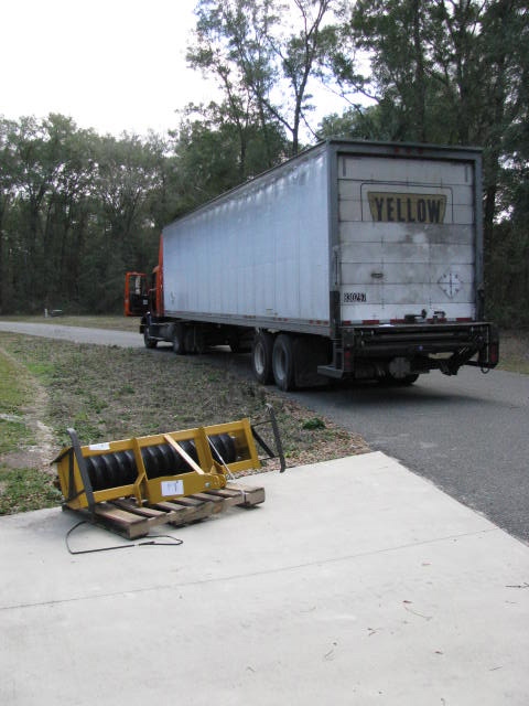

Photo #1 Yellow Freight delivered 60" Cultipacker from Everything Attachments, Newton, N.C., during early January 2013.
Photo #2 Cultipacker on pallet in my driveway. Bill of Lading shows shipping weight of 722 pounds, which includes the pallet.
Well, Jeffrey, age 65, how are you going to get that 700 pound chunk of iron and steel upright, safely?
It turned out to be easy. I reversed the Cultipacker black stands from shipping position to upright support position and tightend nuts/bolts.
Moved B3300SU tractor/loader to far side of pallet, bucket forward. Attached one 5/16" chain via slip hook to each clevis/hitch on Cultipacker, then other end to grab hooks on bucket and reversed in LOW. Cultipacker rolled upright onto its stands easily. I wish I had a picture......

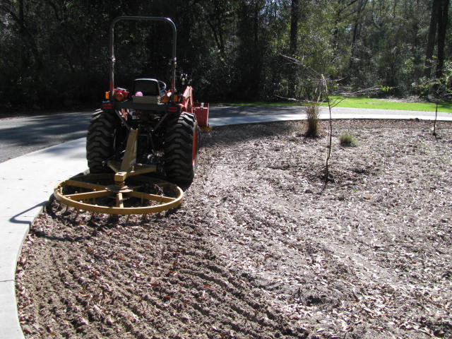

Photo #3 Secondary soil preparation with 60" King Kutter Rotary Harrow. [ from Everything Attachments ]

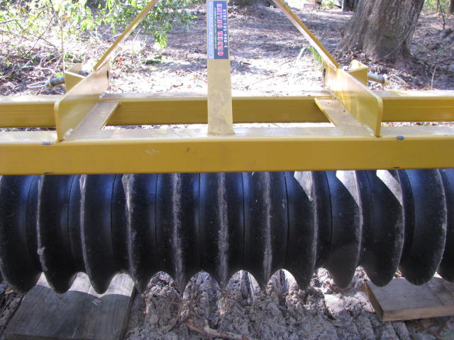

Photo #5 *** Rolling! *** Cultipacker is specialized tool used to roll in fine seed. Note corrugated pattern in soil. In my sandy-loam soil smooth wheels perfect.

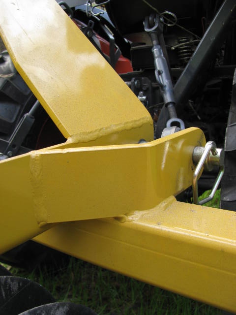

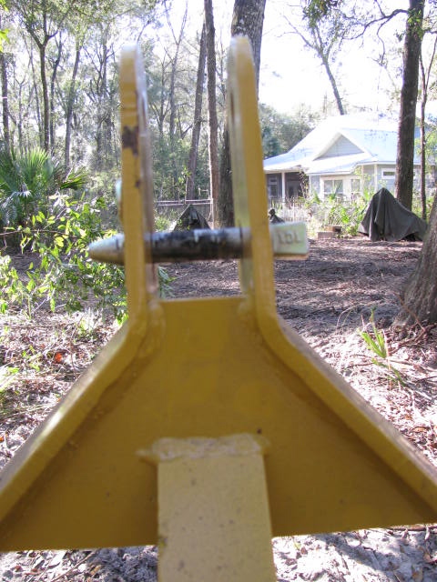

Photo #8 - #9 - #10 Arrived with paint chips on mast; primer coat not evident. Steel pallet strap abrsions on main frame. Frame should have been padded.
I have been using my Wallenstein BX42 PTO chipper for a year. Stuffed tons of limbs in to be chipped. The paint remains flawless. [ Of all my implements Wallenstein has the best paint; it shipped from factory in Canada. ]
Photo #10 Thick steel, nice welds; BRAVO!

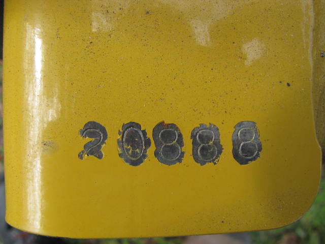

Photo #11 Serial number for ETA.

Just a note about the chipping paint . If " Anyone " Has stood on the dock of " Any " Freight Company , ( Insert Name , be it Yellow , Reddaway , Oak Harbor , Fed Ex, , etc... ) , What could be perfect in leaving the Factory , May NOT be so perfect upon it's arrival . Been There , Done That . The only way to prevent , Actually should say " Lessen " , the chances of shipping damage , is to have skid Larger than item by at least 10" to 12" on all sides plus on top . Problem with top protection is if it has a frame , then someone " WILL " stack stuff on top of it , Even with Warnings painted on frame to Not stack stuff on top . Several Years ago , MIL ordered new pellet stove , Came in Box and crated also . Warnings on box and crate stated to stack No freight on top of Skid / Crate / Carton . When I went to pick up at terminal , Was standing next to skid , reading warnings on crate , watching hyster unstack crap off top of crate !:confused3:
Made Dock Worker and Supervisor write on Shipping manifest that this occured , thus if there was damage upon opening , they were go to eat it . They were not happy about it , but I simply said it was either that or I was calling stove company and refusing it on the dock and Why .
