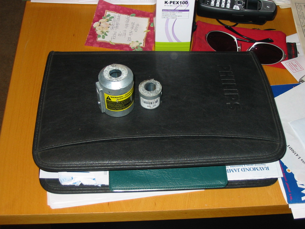

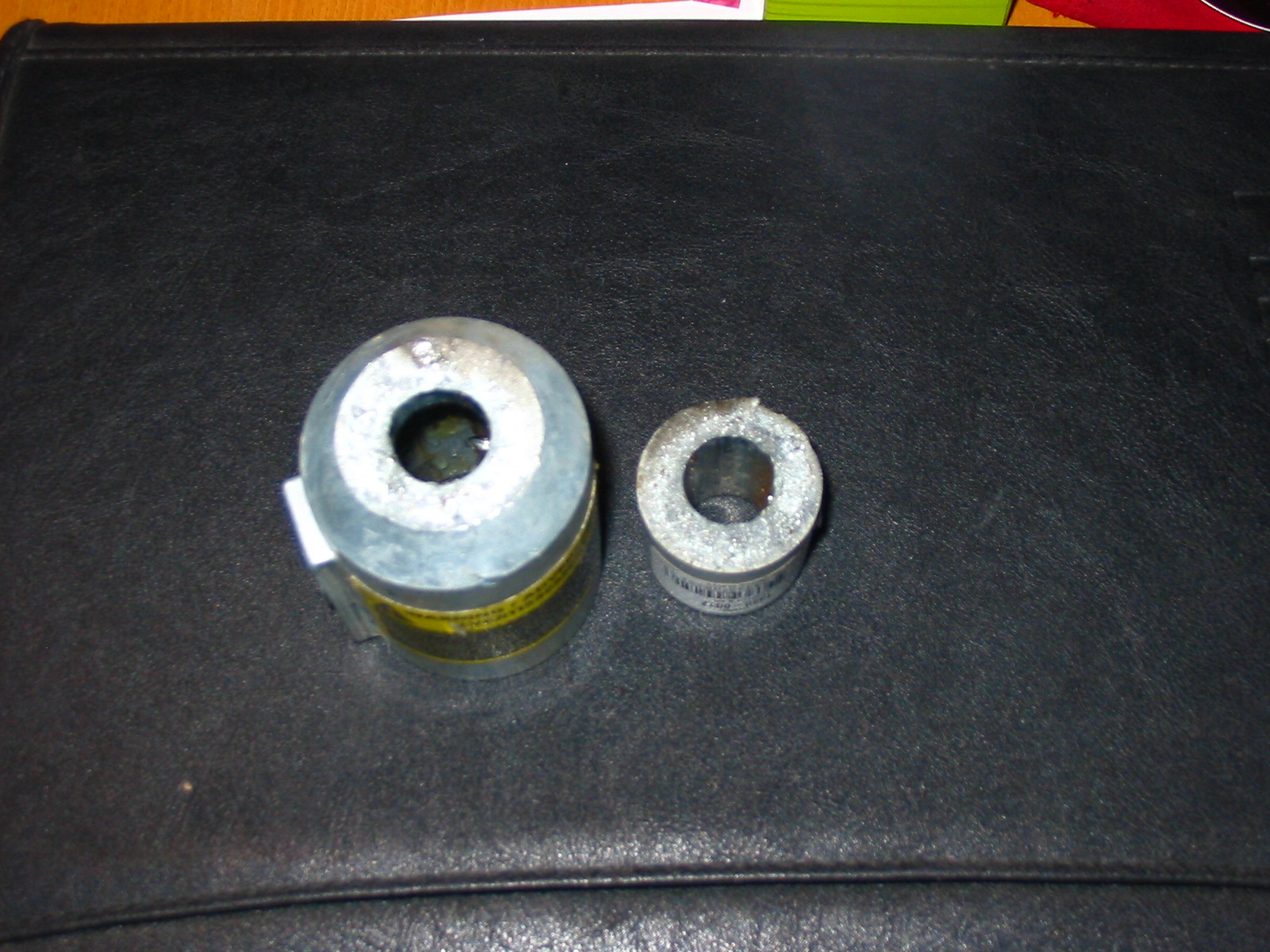

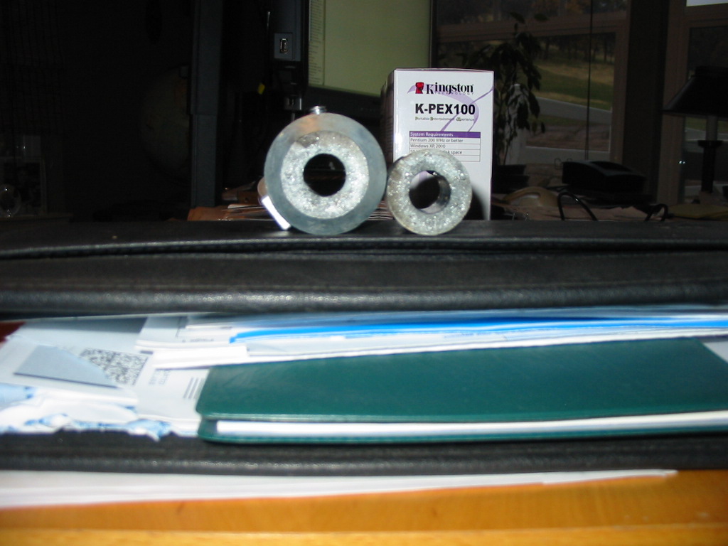

We bought a 60 Gal sprayer from TSC along with a 6 roller pump and the torque arm kit. We finally got around to setting up to test yesterday and while idling, the coupler that connects the PTO output to the pump sheared in half. Upon inspection, this piece is cast and it appears that the casting may have been faulty causing the break. While idling, the pump/PTO unit was rotating fine, the unit was spraying and while we adjusted the nozzles, the darned thing just sheared. The coupler/pump is held in place with a torque arm that uses a spring to enable some movement when under load. We can't figure out why the coupler sheared which is why we suspect the casting. Any thoughts? The attached pix show:
011 - Top View of two broekn halves
010 - Front view of two halves - brown spots on castings are the suspects
006 - Close up of suspect casting
004 - More clearly shows suspect casting brown spots.

I would take coupling back to TSC. I think they are pretty good about helping out with problems.. My wife's uncle bought one of their sprayers that mounts on an ATV (4 wheeler). The plastic spray handle split in two, he carried it back and the guy gave him one off of floor unit. Maybe you will be as lucky, and hopefully it was just a defective part and not anything serious with your pump.
   / 60 Gal. 3 Pt. Sprayer and Pump Problem #3
Todd, I think they will fix that no problem. Mind if I ask what t costs new? My dealer wants 750.00 on a closeout price for a 55 gal one with pump. I thought it was high maybe. TIA, MP
   / 60 Gal. 3 Pt. Sprayer and Pump Problem #4
Hate when new stuff breaks. When I looked at the pictures the words "pot metal" came to mind almost instantly. I'm sure TSC will take care of it.
Zoombah, yes, crappy Pot Metal was our first suspect. This thing should be made a little sturdier unless there's some reason it's supposed to act as the weak link.

   / 60 Gal. 3 Pt. Sprayer and Pump Problem #7
I have the same setup only with the Hypro 8 roller silvercast pump. It works fine. I just did 28 acres of Glyphosate and 2,4-D for the CREP program I signed up for.
Finished the spraying the day before Thanksgiving which is quite late here in Michigan. It is killing down fine, but we have had snow for a week, so I can't see the weeds. The weather is warming up so the snow will be gone in a day or so.
I think you got a bad casting.
