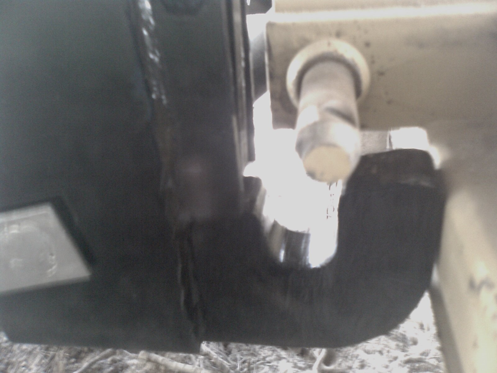

It didn't work on my wide version of the HF quick hitch without modification to the hitch. I had to cut and grind off about a 3/8 inch of the hook parts to make it fit.
I had the same problem as Cocre so I had to grind some off of the QH.
Newt92 or Cocre,
You wouldn't happen to have a close up picture of the hook with the tiller mounted would you? I noticed that what looks like a bushing on the bolt that goes through the frame there, doesn't bottom out inside of the hook. I was thinking of getting the top adapter bracket and using that. I ran out of time today to keep messing with it so probably won't get back to it until Wednesday or so. Thanks for the help.
Newt92 or Cocre,
I don't have a picture, but I do have the adapter. I have just about given up on the QH. I could never get it to work right with my KK brush mower. The top link connection has to be able to float to allow the mower to tilt up when going over uneven ground, even with the adapter (which wouldn't fit at all in that situation) the mower was locked for the most part. I have debated buying Pat's or one of it's clones, but with my JD 3320 the hitch arms can be spread apart and held in place by the sway links (they are not just chain) making it fairly simple just to spread the arms apart and back up a straight as you can. I also now have hydraulic top and side links that make for easy adjustements.
I also opened up the QH toplink hook in hopes of getting it to fit the tiller without the adapter. I get it to work, but use the adapter because it just works better.

I ordered the top link adapter for the QH last night so will see how that goes. I thought about trying to open up the hook also and might go that route. Other than that after I ground some of the QH off, I was able to back right up to the tiller and connect the hitch arms, it was just the top link that wasn't fitting just right.
I was also looking at Pat's thinking that might be easier route to go.
Newt92 or Cocre,
Guess my mind is slipping, I forgot I had to tweek a bit. Yes I had to grind some off that bushing. I think about 50% around where it contacts the "U" part of the hitch on each side. Also, like Cocre says, I also had to cut (w/sawall) some off the back part of the "U" hook on each side where it contacts the tiller during hookup. I can get pictures of what Im talking about tonight and post them up, getting ready to leave for work now or I would get them now.
