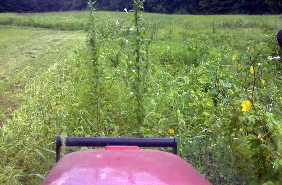

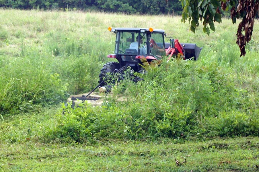

I use a 6' Landpride rotary cutter behind my 33hp diesel MF 1533. It's 20 years old so has a heavier frame than its successors being sold today. I can mow 7 acres of this stuff in about 4 hours IF it is fairly dry. If it is wet and lush, then add at least another 2 hours because I have to drop down a gear or two or even take partial cuts to get it as low as I like it. I think you will be happy with your choice of a 5-footer.
  • 2011-08-22 view towards the North end of field from tractor cab while mowing field-2.jpg
