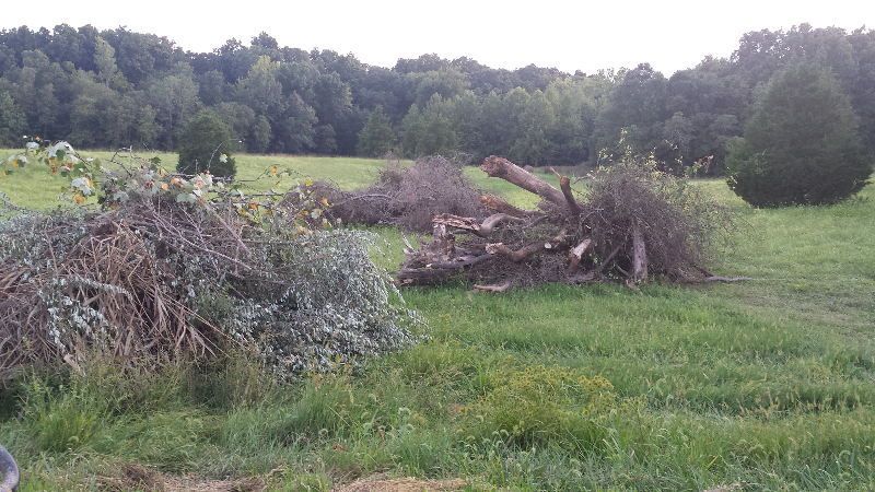

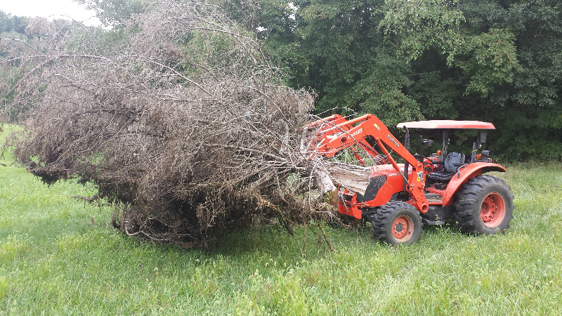

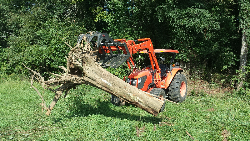

Had two different 48" grapples. I would not want it wider. In addition to the piles of stuff I've stacked up another pile which is 50% larger has been added since the picture was taken.
And... This android app is crashing when i add the pictures. Developers take note. Take me word for it..... Got a lot of big piles... And long logs to burn. All move with 48" grapple.

Well app crashed but pictures took..... which i thought didn't. BTW still have about 40% more to go. Going to have quite the fire.
