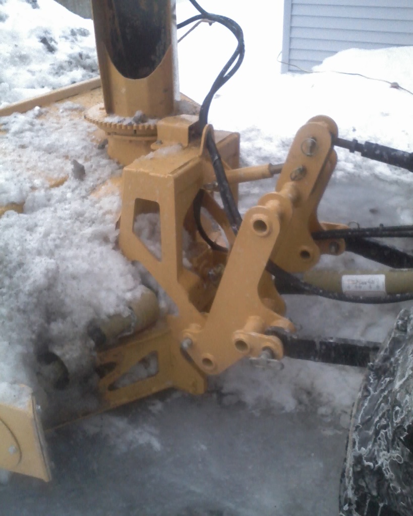

I recently purchased the 60" Buhler Snowblower for my 3720. Now am thinking about increasing to the 72". Anyone have any experience with the 72" on the 3720?
Thanks,
DW
It's not as much the size that matters than the weight. I have a 72" industrial blower on my 4720 that is rated 60hp to 125hp and weighs just below the maximum this tractor will handle. On the other hand I know a guy who has a wider but lighter blower on his 3720. A blower's HP rating usually gives a good indication on what to expect in terms of compatibility. This is mine at the end of a snow run:
The heavy-gauge steel construction is necessary for the ice condition we have here.
   / 60" or 72" snowblower for 3720 #13
Tha is a nice blower. I did not know they made a blower that size. Their website only lists a large double auger one. Do you have any other information on it. What is the weight on the blower?? Cost?? I especially like the 3pt frame on the blower.
   / 60" or 72" snowblower for 3720 #14
This particular unit is a demo that Shoule has made available to a number of dealerships in the Northeast and parts of Canada, roughly the area where distributorship is covered by the manufacturer itself. It will be available to all customers as a 2009 model starting in February (there will also be an 84" model available for tractors in the 125hp-200hp range.) My dealer had ordered me one last September thinking they would be available in November. His mistake, so he lent me this one until the new one arrives. Nice gesture considering it forces him to use a larger model (and a larger tractor) to clear his lot, as he had intended to use this one.
It is made in Canada and distributed across North America. According to the leaflet (which I have unfortunately misplaced) it is only described as a "compact industrial blower" meant to be used on the larger CUT's and full-size tractors up to 125hp. If I recall well it listed the main benefit as being able to use more fuel-efficient tractors to perform smaller jobs that previously required larger machines nonetheless due to the size and weight of standard industrial blowers.
It weighs approximately 1900 lbs dry, which is within the extended lift capacity of many large CUT's including the JD 4720. Cost is about $6,000 (US), a little more if you opt for a telescopic chute for 10-wheeler loading (I didn't) and/or skid shoes with retractable rollers. Those small rollers are meant for minimizing gouging while blowing gravel roads and such.
So far I am satisfied with this blower, although its weight can cause the tractor to skid when pushing up grades so I try try to push downwards whenever possible. When going down even a very slight grade it's next to impossible to bog this thing down, its shear weight keep it close to the ground and pulls the tractor along so very little traction is required to deal with even with 3'-4' of very heavy compacted snow. On level surfaces it is sometimes necessary to gain some momentum in order to blow through large snow/ice banks but it's well worth the effort. If there is ice on the ground I raise the blower 2-3 inches and its blows through anything.
As far as fuel is concerned I have not noticed a huge difference compared with lighter blowers, despite the weight. One major difference though is road handling, this is one instance where you don't wish for a faster tractor. Takes some getting used to but eventually you get the hang of it and drive accordingly. I think the heavy reversible FEL snow bucket I have on order will help in this regard, in the meantime I usually carry a bucketful of heavy snow in front while driving from one job to the next otherwise roll and sway limits speed to 10mph.
Yes, that's what sold me on the unit as well. It's well designed and extremely sturdy.

What exactly is this? Does it allow the blower to "float" fore and aft to allow it to follow the ground? Or....... just a redundant adjustment like adjusting the toplink?
What looks like a black rod is for adjusting tilt, what looks like a shock absorber is a system that allows the bottom of the frame to bounce up if it hits a major obstacle, at least in theory. In practice it's better to know where the obstacles are and avoid them. Last week I inadvertently tested this feature and shattered a chain sprocket. Not a big deal, I had a spare and they only cost $12 but still.
This has to be the nicest three point blower i've ever seen.
Industrial-standard blowers of this size are becoming more common as CUT's are gaining popularity with public works departments and other agencies that are being pressured into using more fuel efficient machinery. They want smaller tractors but they still want the near-indestructible implements that used to come only with larger machines. Individuals who do commercial snow removal also find them attractive for their capacity to withstand rough handling.
