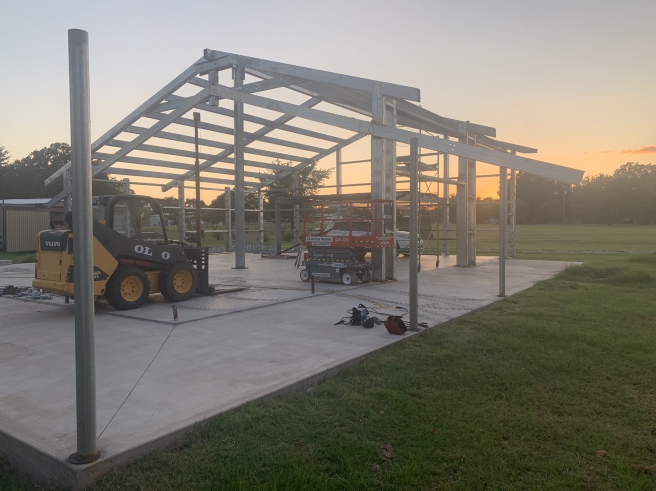

I have a Maxstar 150 (Miller) and I use 5P+ exclusively. 90 amps on 115 volts 1/8 rod and I prefer the arc over arcs on my Dialarc 250 or Legend gas drive. 60 amps 1/8 welding up 14 ga galvanized C purlins
