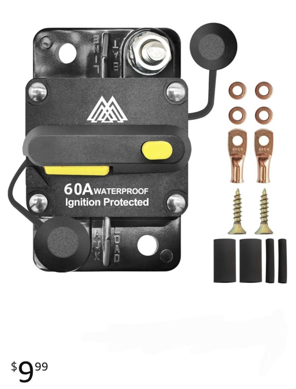

All I did for 43 years, and actually still do after 11 years retirement is troubleshoot electronic problems. I had to be creative. I never liked blowing fuses ($). A light inserted does two things: now it's a current limited circuit and a dead short lights the bulb. Of course the available current depends on the bulb itself...or parallel it with a shunt.
Of course a 60 amp circuit gets "tough" because now we're at 700-800 Watts depending on available battery voltage.
I prefer a circuit breaker, at least temporarily instead of fuse like this (Amazon of course) $10 one.
Try different things until it trips.
