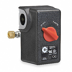

Your compressor should have a control switch (similar to the attached pic). By removing the cover there should be an adjustment screw that will allow you to lower the cutout pressure if you so desire. You say the cutout pressure is 155 and max input pressure to the HFfilt/reg is 145. IMO those pressures would be close enough and not need adjustment. If you do need to adjust the control switch it won't take much adjustment to lower.
/ 60gal vertical ac installation ? #10
Unless you need a lot of high pressure air I would bring the cutoff down to around 125.
In my opinion running a single stage that high if not needed is working it to hard.
My system is regulated to 90# out the regulator with a cut in at 85# and out at 115#.
